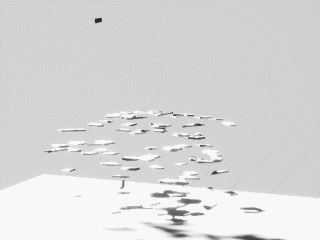

Hey guys, I am experiencing an issue where I sim and export an rbd animation out of Houdini (vertex_animation_textures_beta1) and it is totally different in Unreal. Not what I expected. I have tried an older version of the beta and I have tried the latest one on github and I get the same results. I have attached gifs and the hip file.
Any help would be greatly appreciated Thanks!

Looks fine on my side. Have you:
Set your compression setting on the images to VectorDisplacementMap
Set the Filter to Nearest
Turned on “Use full precision UV's” on the mesh
Set all 4 bbox min and max values
Mike
Joined: Oct. 2015
Hey Mike I really appreciate your help. It was the texture settings. Works great now, Thanks!
