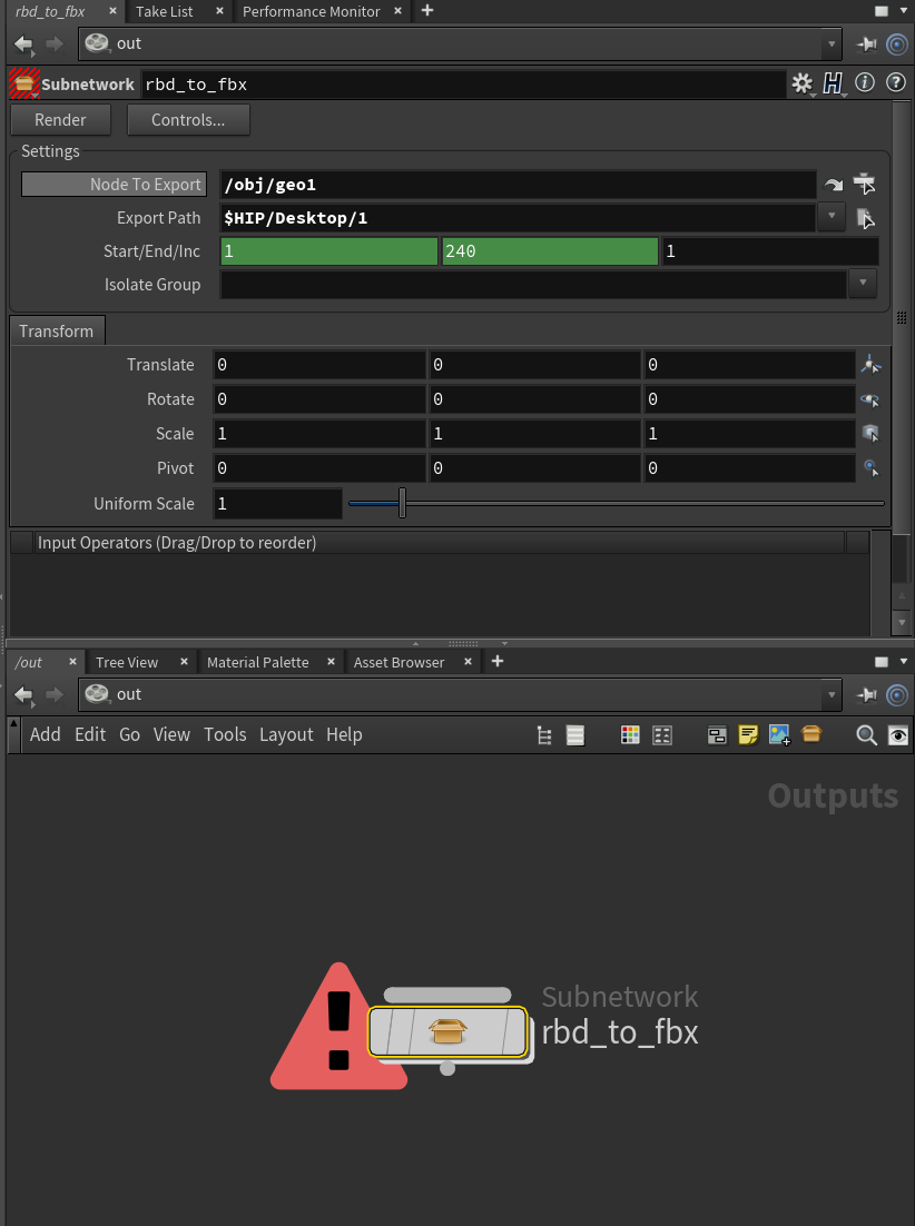

I have an error too.
It's a scene with just 1 standard geometry cube and RDB to FBX export (game shelf) node in output
Then, I hit render and got an error
Error
Error rendering child: /out/rbd_to_fbx/shell1
Error
Python error: Traceback (most recent call last):
File “”, line 1, in
File “C
PROGRA~1/SIDEEF~1/HOUDIN~1.20/houdini/python2.7libs\gamesutils.py”, line 15, in rbdToFBXCExport
exporter.export(hou.node(export_node))
File “C
PROGRA~1/SIDEEF~1/HOUDIN~1.20/houdini/python2.7libs\gamesutils.py”, line 49, in export
self.get_selection(export_node)
File “C
PROGRA~1/SIDEEF~1/HOUDIN~1.20/houdini/python2.7libs\gamesutils.py”, line 69, in get_selection
self.verify_selection()
File “C
PROGRA~1/SIDEEF~1/HOUDIN~1.20/houdini/python2.7libs\gamesutils.py”, line 78, in verify_selection
self.verify_packed_prim()
File “C
PROGRA~1/SIDEEF~1/HOUDIN~1.20/houdini/python2.7libs\gamesutils.py”, line 86, in verify_packed_prim
raise hou.Error(“Please select a packed primitive object to export”)
Error: Please select a packed primitive object to export
Houdini FX Version 16.0.504.20
I tried different game shelf brunches (stable, dev, 16)
Looking forward to help, thanx
