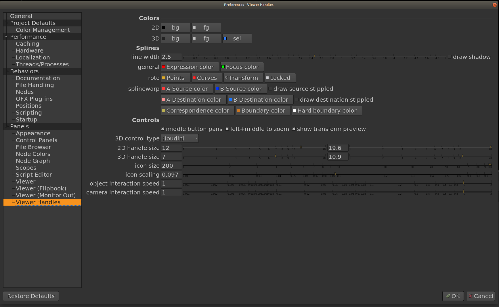

Definitely would like a control like in Nuke ‘camera interaction speed’
Edited by anon_user_37409885 - Nov. 15, 2017 15:36:37
Camera interaction.png (173.0 KB)
