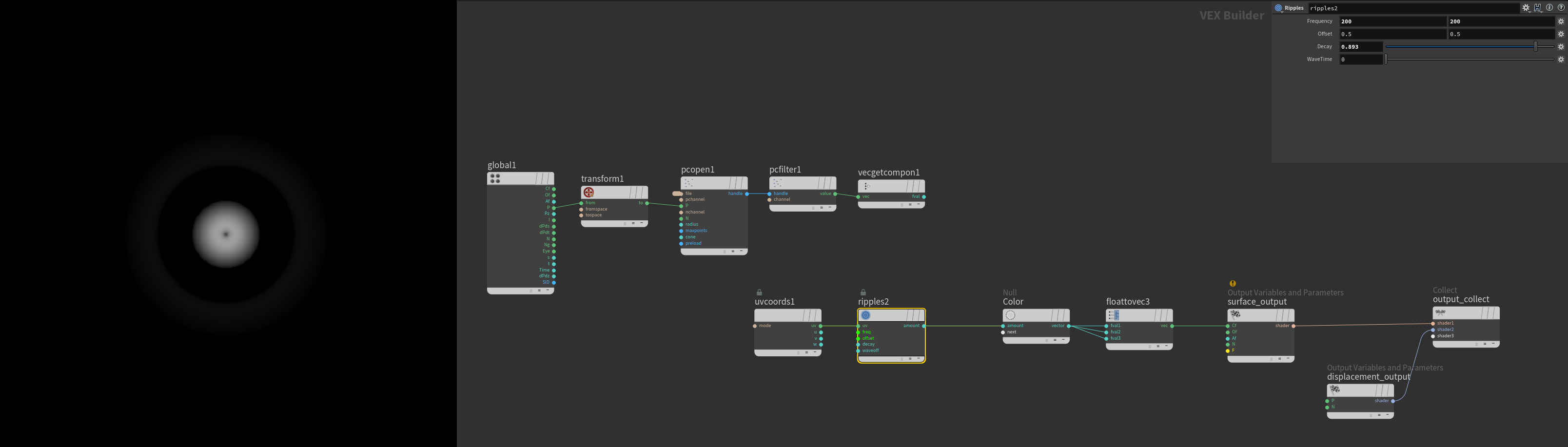

My goal is to add the ripple VOP to every point in the PointCloud hitting the FLIP mesh(geo1).

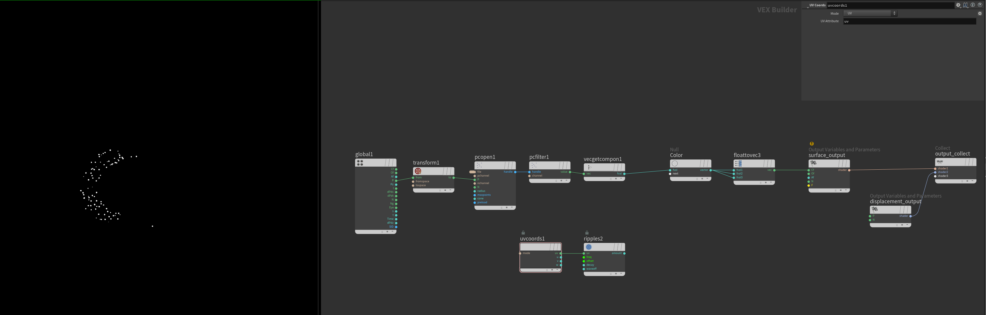

I managed to have the points with Point Cloud Open and Point Cloud Filter in the Material Builder and they show up in the render.
I also have the ripple VOP connected with grid (geo2) UV's and I get one ripple.
Now I would like to add shader based ripples to every point coming in into the material when they hit the surface (geo1) and they should last for a given time even if the point is already killed (beneath the surface (geo1).

Ok lets try:
- get the position of the pixel to be rendered.
- find the closest points in your point cloud
- get the distance to the point(s) in the point cloud
- now you need to also write your own “ripple”
Just planar UVs or a rest position needed…
its a bit tricky to get the world space local space thing right.
Maybe you should first write a shader that just puts a white point where ever a point of your point cloud is…
From there you can expand to ripples…
