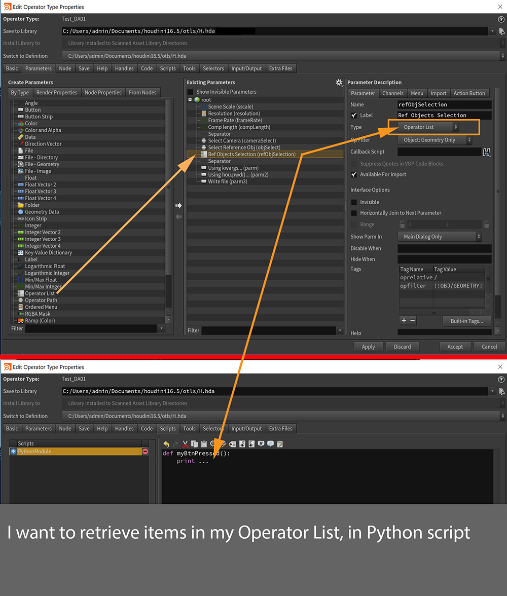

Hi; I create a button in my digital asset that runs a function called “myBtnPressed()”. I also add a “Operator List” to select some geometries from my scene. Now I would like to retrieve items in my “Operator List”, using Python script, but I don't know what how… Thanks for helping

I wrote these codes :
print hou . evalParm ( "refObjSelection" )
Now it show my selected object like this :
/obj/grid_object2 /obj/grid_object1
But I want separate each item by index, something like :
print hou . evalParm ( "refObjSelection" )[ 0 ]

I found these codes to solve the problem :
print hou . evalParm ( "refObjSelection" ) . split ()[ 0 ]
