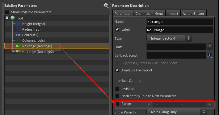

Joined: Aug. 2013
tag:
"sidefx::slider" set to "none"
seems to do the trick
