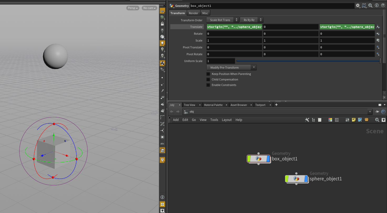

So here's what I did:
Create a cube and a sphere , positioned the sphere at 4 above the cube.
In the cube's parameters pane > tab “transform” > added these expressions in X and Z : vtorigin(“”, “../sphere_object1”) . Check attached pic.
Now when I move the sphere in X, the cube moves, but in a weird way, it progresses on the grid along a 45° axis.
Moving the cube in Z does nothing.
There must be something missing, I should be able to access the global X and Z translation of the sphere…

Grendizervtorigin() returns vector, and since you are not specifying which component to use, both of your parameters use first, so both are controlled by sphere's global X position
so you want to specify components for X and Z respectively like this:
vtorigin("", "../sphere_object1")[0] vtorigin("", "../sphere_object1")[2]
but you can as well just create Blend Constraint and uncheck TY
