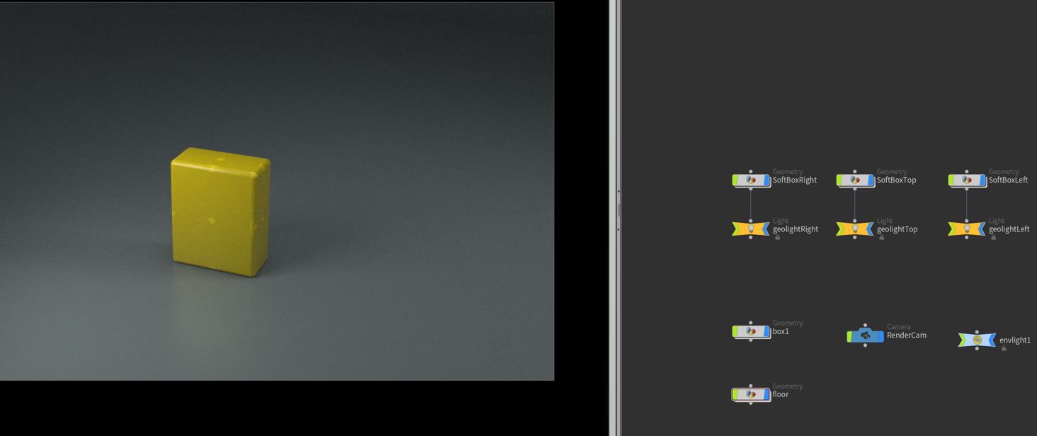

I am trying to have an emissive shader contribute to light and shadows but it doesn't appear to do so. What am I doing wrong? Thanks.

Before looking at your scene, the first thing that comes to mind is do you have diffuse bounces?

I don't think I have any diffuse bounces. They only way to make the above file actually work that I can see is to add a geolight and pick the softbox. I'm not sure why that is necessary, as the light emission shader is set to light objects.

as mentioned before to make pure emissive material light your scene, set diffuse bounce limit on Mantra to at least 1
so while geolight is not necessary, it is still advised to use it in your case as if will provide better sampling than just pure emissive material

Thank you for the suggestions. I added those and the shadows look better, but the render times are awful and there are strange artifacts on objects with a principled shader. I'm not sure what is going on, but it is probably user error.

9436 posts
Joined: July 2007
you are rendering your softbox objects also using them as lights so they are shadowing themselves causing your artifacts
so either don't include them in render and make your geolights renderable or remove them from shadow casting
also instead of geolights can youmaybe use area lights with texture, if your only purpose is to emulate softbox?

The reasons for using a softbox rather than area light are:
1. ability to control direction and angle of light
2. to better replicate reflections in a studio environment.
Maybe I can replace the geolights with an area light approximately the size of the emissive portion of the softbox and make it a child of the softboxes. I'll try that to see if it works better.
Interestingly, it appears with making a geolight from an object, it uses the materials on the object and doesn't light in the direction that the portions of the object are shaded black.
