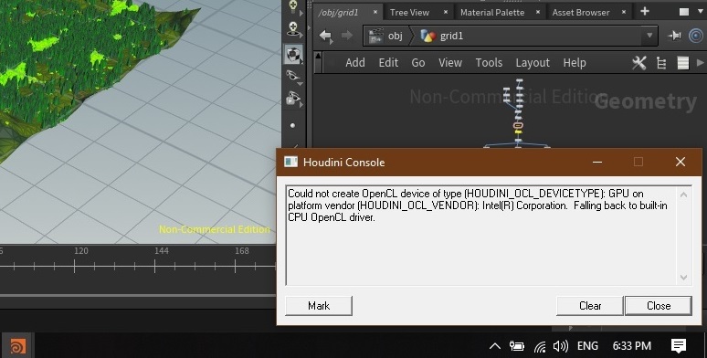

I've seen some posts re: this issue but all have involved adding some code to a Houdini environment variable? to get it to use my GPU rather than CPU. I've only just started learning Houdini so I have no idea on where to add code as an environment variable or whatever it is I'm meant to do. Just hoping someone could explain to me in relatively simple terms on how to fix this. Cheers.

If you are using Windows then the houdini.env file will be in the Windows documents folder. Open it with the notepad editor and underneath all of text that's already in there paste this code.
HOUDINI_OCL_VENDOR = NVIDIA Corporation
HOUDINI_OCL_DEVICENUMBER = 0
Then save the env file and start up Houdini again. When Houdini starts click the ‘help’ tab. Then at the bottom of the list choose ‘About Houdini’ and in the window that pops up put a tick in ‘Show details’ check box. Scroll about half way down to where it says ‘OpenCl Platform’ and it should now have your GPU listed.

Thanks paulcorfield.
I've added to houdini.env file & seems to have fixed the issue (see updated copy of houdini.env below)

I actually downloaded Nvidia optix the other day to see if that would help, which explains what was the last line of txt on the houdini.env file before I added the txt you provided below it. Not sure if having optix helped or not & not even sure if I needed to download or not.
I opened up the same file I got the message on the other day to test & no message so hoping that has fixed the issue. Thank you again. Legend.
