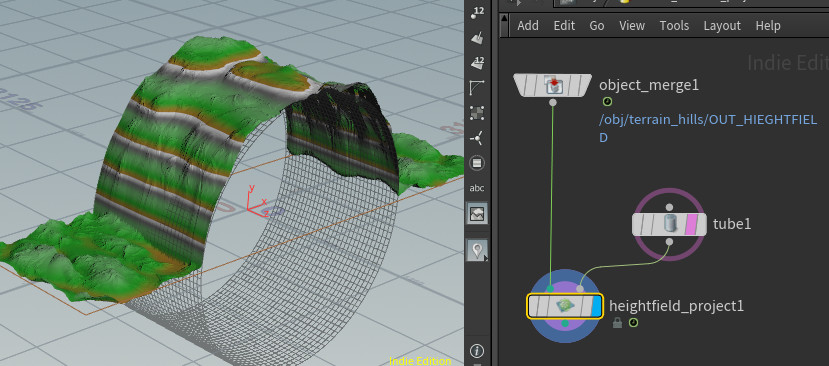

Well I just tried something additionally too.
After mirroring create a new heightfield of the same dimensions;
Then feed both the heightfield and the mirrored polys into heightfield project.
So now you can carry on with the other heighfield tools to make it look as ‘natural’ as you want.
After you can use that as a texture and map it on to a cylinder for displacement.

Fantastic, Babaj. I'll give that a try right away. Sounds like a winning recipe! Much Appreciated.

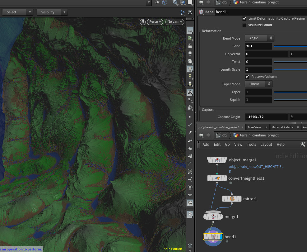

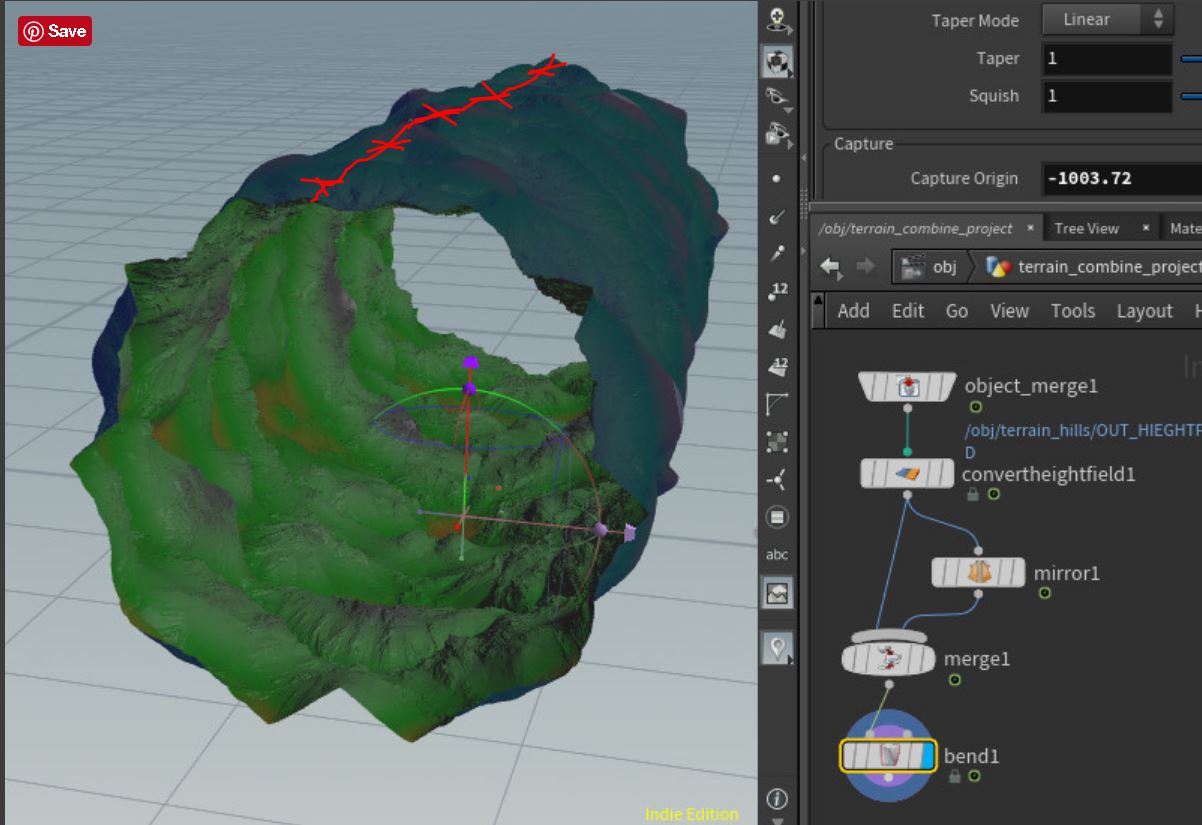

I guess you can use a bend node if all you want to conform to is a tube shape.
The problem with mirroring is… well… that it mirrors stuff. Ideally we'd want an overlapping heightmap with a fade on each side, assuming the fading mask isn't linear (some zigzagging) i might be able to get away with a geometry overlap so each side would be the opposite side of a matching canyon or something. I just don't believe in perfectly seamless junction with mirroring, the mirror line will still show unless it's some very smooth centered spherical hills or so.
I love the terrain tools, but not being able to apply that seamlessly to a tube/sphere is a little bit of a downer at times.
Thanks a lot, going to keep trying all proposals.
Actually, no mirroring line will show, the mirroring node will make a perfect seam.
The reason you know the seam is there is because like you say, it mirrors. That's how you can tell where it is, it's not the seam itself.
So how about determining the entire size area needed for ‘wrapping’ around your cylinder and do a single heightfield for that.
Then because each side will have the same number of points along the edge(the two sides that will meet at the seam);
Run a wrangle that matches the P.y values from one side to the other. At this stage the one side that got it's y components changed will look like crap because they are out of place in relation to the terrain on that side.
But then keeping that edge intact, do some modeling that changes terrain making it ease into the points.
Now when you wrap, you get no seems and the there isn't any ‘implied’ seams, from mirroring.
