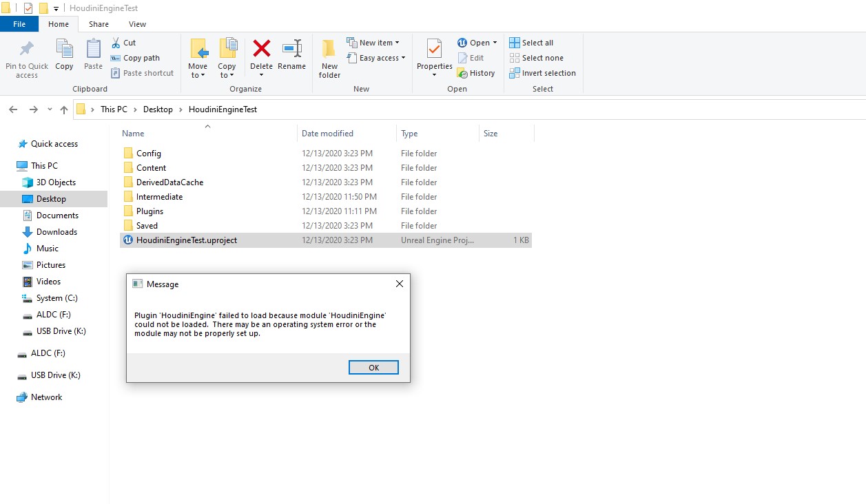

Hi guys, im having the same issue.
Trying to install 4.26 houdini engine for UE4 from github (houdini18.5-4.26 binary build) following these instructions from the github installation:
Installing the plugin
Download the pre-built binaries of the plugin in the "Releases" section of this repository.
Extract the "HoudiniEngine" folder in the release to the "Plugins/Runtime" folder of Unreal. You can install the plugin either directly in the engine folder (in "Engine/Plugins/Runtime/HoudiniEngine") or in your project folder (in "Plugins/Runtime/HoudiniEngine").
Start Unreal Engine, open the Plug-ins menu and make sure to enable the HoudiniEngine v2 plug-in (in the Rendering section). Restart UE4 if you had to enable it.
.....and gettting the following error when launching UE 4.26:
Any ideas?
Screenshot 2020-12-17 130114.jpg (17.0 KB)
538 posts
Joined: Sept. 2016
You're getting this error likely because the binaries you're using were not built for UE4.26, or because you just have the source code.
As Beta2 was released before UE4.26, the binaries currently available on the git repo's release page are only for 4.24 / 4.25.
You can download the source code for the 4.26 plugin, but that would require you to build the plugin from source, or you'd get this "missing module" error.
What I'd recommend, is that you get the latest daily H18.5 build.
You'll find the 4.26-v2 plugin under the engine subfolder of your Houdini install directory.
Copy the HoudiniEngine folder to UE4.26's Engine/Plugin/Runtime folder, and you should be good.
