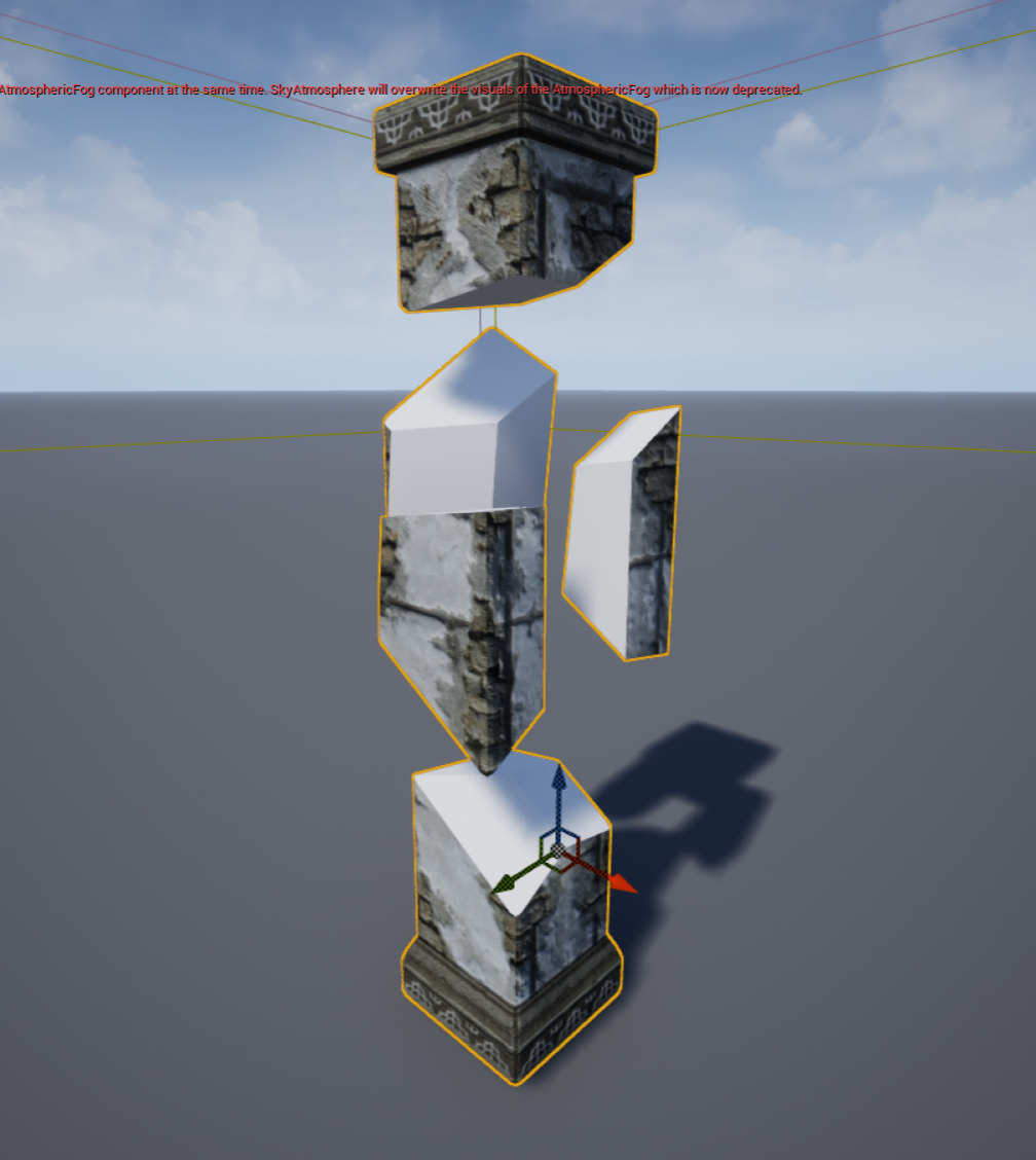

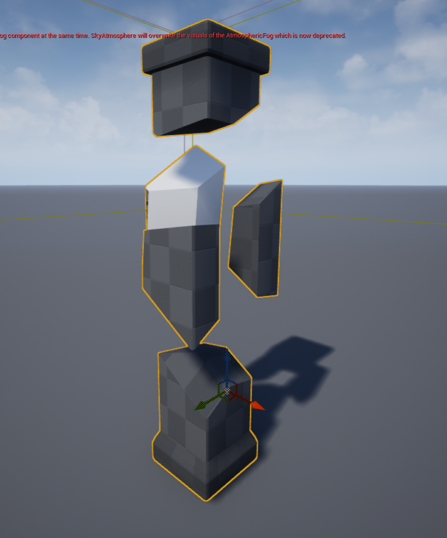

I would like to share an issue I'm having with HoudiniEnginev2.
I did an HDA that basically fractures objects but I just realised that in Houdini Engine 2 the materials are lost something that didn't happened in the first version. ( here a couple of screenshots).
The one without textures is using the same HDA the unique difference is Houdini Engine v2
Any workarround or clue?
Many Thanks,
Oscar

@Josich : Hard to tell what's causing the issue just looking at the screenshot, but materials should be support similarly in both v1 and v2. Please submit a bug report for that and send us your HDA so I can have a look.
