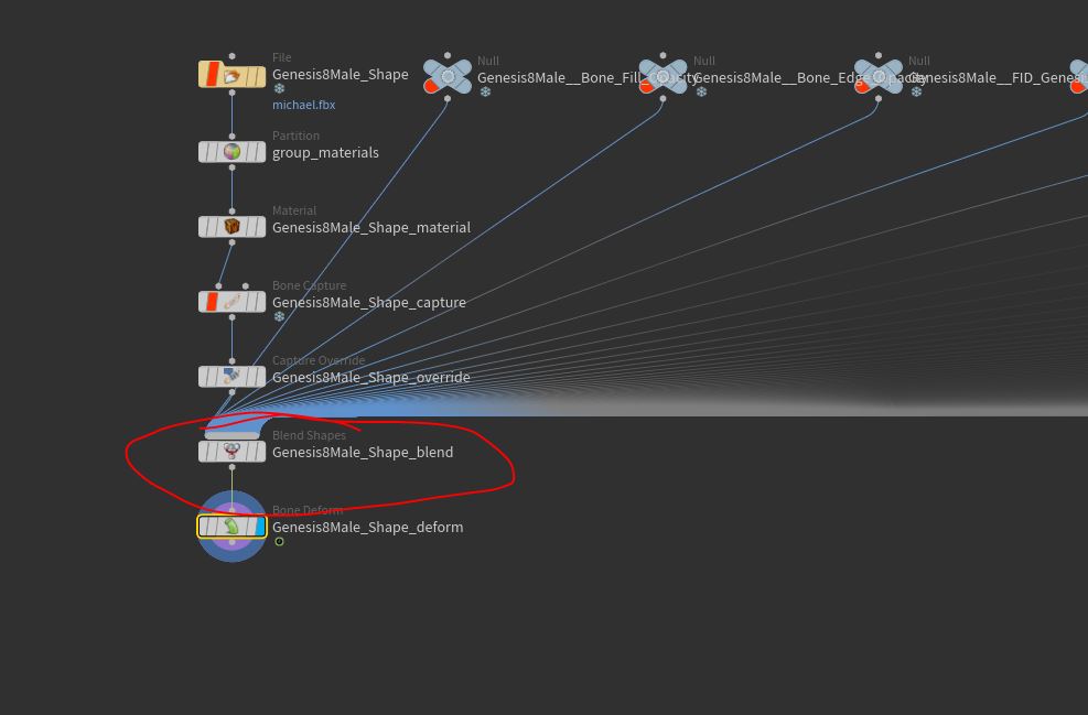

Moin, Henry,
when you import the FBX from DAZ into Houdini (and choose to “import blend deformers as blend sops”), you get a mesh-deforming node that has “dials” for each morph (aka “blendshape”). You could write a script that exposes those dials to your own control UI - or apply surface-controllers so that you can “click-and-morph” on the face directly.
BTW, technically speaking you can convert a DAZ rig to Houdini without having to recapture. However, in my experiments I found a recapture in Houdini, using the original rig (just converted to Houdini's bone system instead of the Joints-system), more convincing (people say that DAZ' weighting is so good, I don't subscribe to that).

Hello, malbrecht
Thanks a lot for your input
I think I already have what you are mentioning here: I do have all those blendshapes as inputs when i import the DAZ fbx into houdini
The problem is after i do the autorig capture, the connection between the captured mesh and the blendshapes are completely broken
When I try going back to the original mesh and tweak setting on the blendshape nodes, nothing happens on the new Autorigged mesh

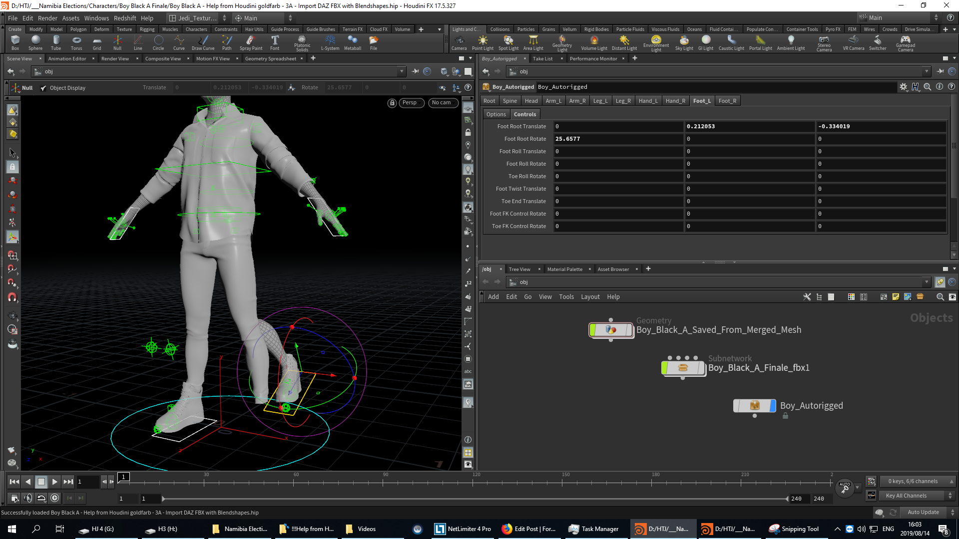

- goldfarb
- 3467 posts
try this
I've made a number of changes - mostly to reduce the file size
see notes in the HDA
the workflow is basically this:
copy the blendshapes from the FBX into the geometry level of the character
add a blendshapes node and blend ONLY the original blend geometry - in this case the head and hands, like in the FBX
then use the lattice SOP, in point mode with a very small radius to capture just one point per point, to deform the full geometry
this is very messy and in Houdini you don't need (and shouldn't) have duplicate meshes to represent your shapes - you can just use very efficient Edit SOPs
you can use the hscript command ‘sopcreateedit’ to create an edit SOP that holds the difference between two SOPs
I've done this in the HDA
after the stash SOP I saved out the mesh with the capture attributes to disk
then saved it into the Extra Files section of the HDA
read that into sops with a file SOP
wire that into a blendshape SOP, then all of the new edit SOPs
then that goes into the deform SOP…
hope that helps

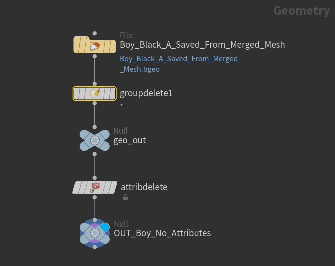

Thanks again for your help
Being still a learner in houdini, im am stuck at the beginning because i notice you converted the file to a .bgeo.sc format
I tried using file cache to export the file to this exact format but it gives error
So i ended up merging the body, clothes, and shoes into a merge node and exporting the file as a .bgeo and then opened a new file
I deleted all groups and all attributes before the export
I then did autorig on this new .bgeo file, but when i do autorig, it rigs the cloths separately from the body, basically it treats them as separate meshes. I have attached the pictures
I do not know if they are being treated as separate because I used the merge nodes to export

I managed to get the hole mesh exported as .bgeo.sc file thank you
Im trying to follow along what you did inside the file you sent me. Its proving quiet hard to follow for a newbie like me. Yes a video showing how you hooked up the blend shapes after applying autorig will definitely be so autorig
Thank you so much
