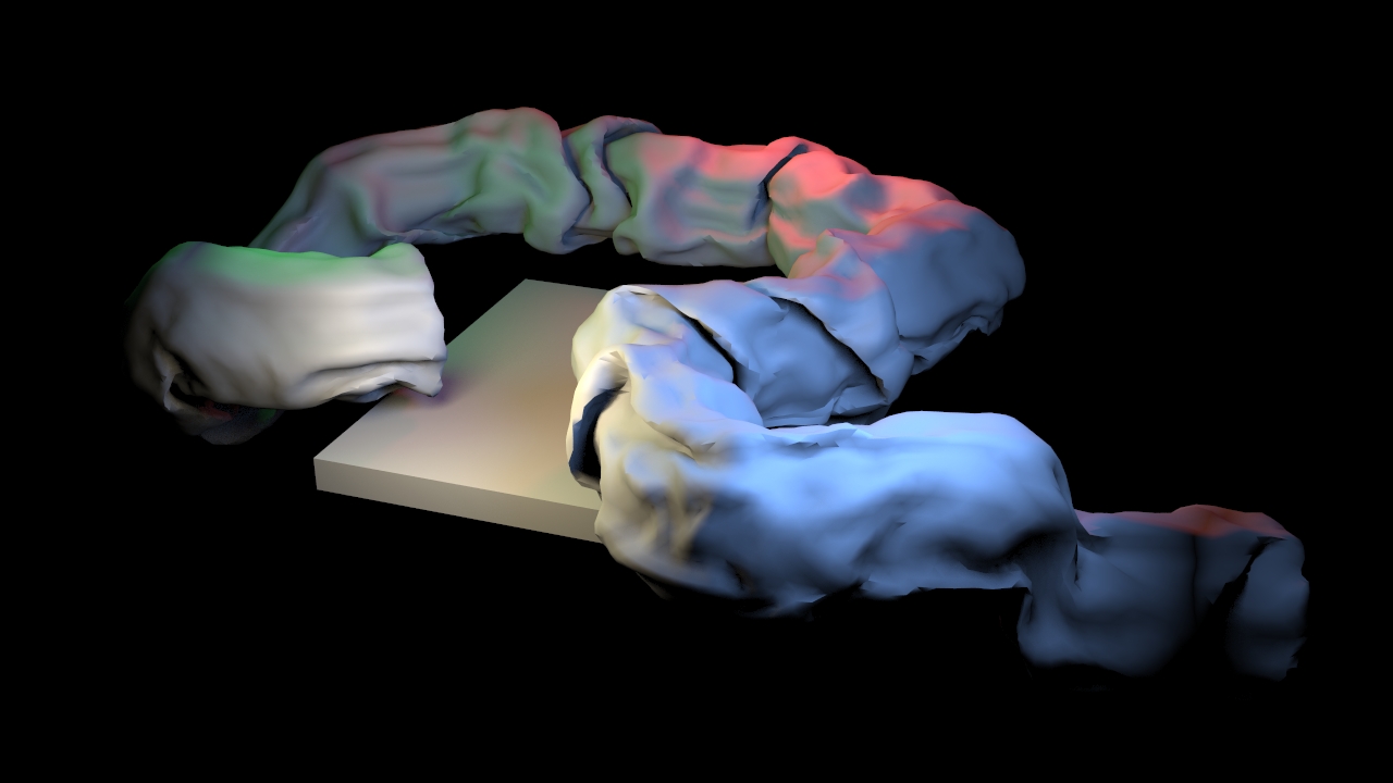

they are not copied over and over again , it's a tube that is simulated with seams
not copying over and over again
I thought vellum would substitude marvelous designer at least on some level
now it appears that you need to write code and make some difficult stuff to achieve simple wrinkles on massive object
need to stitch cloth on metalic object create seams on it and bump them with pressure forse
it's not helping while we have no answer it is possible or not
on the other hand possible is everything because houdini can do that , but how how much efforts we need to put into it
week , month with vellum ?
I would say it's even possible in sketchup but you can imagine how many time it will take to do

Have you watched any of the Vellum masterclasses? They go into details about how to use constraints, and other attrs to control vellum.
One way would be to use something like this to control other attributes like glue strength on constraints or stiffness and rest length. All of these can be controlled to make wrinkles. So yes you can use an image sequence if you wanted.
https://forums.odforce.net/topic/41755-vellum-use-cd-attribute-to-animate-rest-length/?do=findComment&comment=199731 [forums.odforce.net]
Here are a few hacked together samples using an image seq to shape things.

thanks for answers , I was just wondering if such wrinkles are possible at all.
I'm not a vellum pro but in same time never seen such things there.
FEM sometimes looks more like that rather than vellum …
But in cloth simulation being able to do that kind of stuff is very important
if making such thing in marvelous designer is 100 times easier than in houdini than what is the reason of houdinis vellum at all.
P.S.
best and more attractive way to do that would be just making a mesh and possitioning a seams on it , many many of them , like in MD (you can create line on cloth and tell MD that it's a seam , that's it)
after that you typing a pressure value and seams are making nice wrinkles. I assume it's not possible in vellum.
P.S.
