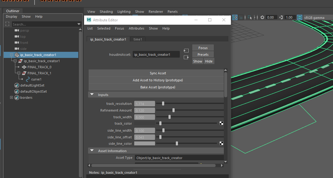

I am making this procedural race track in Houdini to use in Unreal. I wanted to try exporting and using this into Maya. Because at work we mainly use Maya, but when i use the HDA, into Maya i loose all the curve properties to modify the “race track”.

Hi fedekendoka,
What do you mean by “curve properties”? Do you mean the CVs? HDA Parameters?
