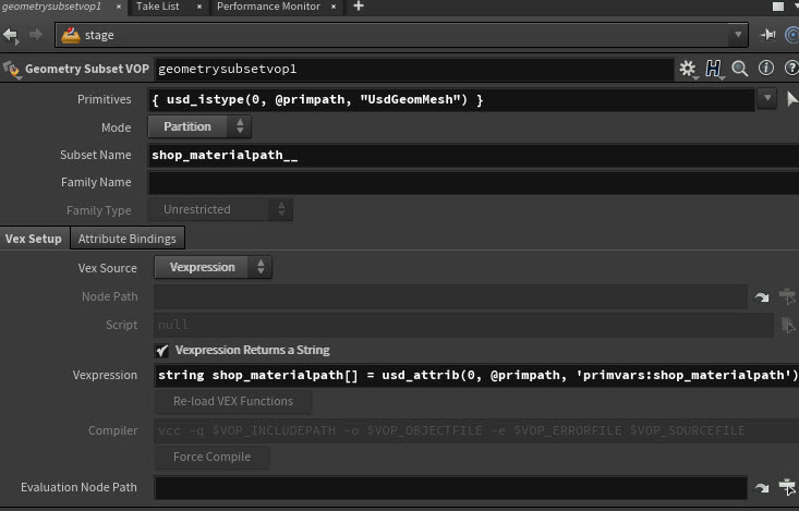

Good thread! Would anyone have any pointers in how to use a wrangle to partition all USD “Mesh” primitives into “GeomSubset” primitives under the mesh? Recreating the ‘partitionattribs’ functionality of the ‘SOP Import’ LOP, but across all mesh objects on stage.
Going over the vex functions for USD now, but haven't cracked it yet. Thanks.

1473 posts
9krausec
There is also a Geometry Subset VOP LOP, with mode parameter set to “partition” and vex source to “vexpression”.
66 posts
Rafal, using Geometry Subset VOP LOP as you recommended was far more straightforward (and probably more efficient) than writing it all out in VEX. Got it working. Thank you, thank you.
My setup below for folks looking for this in the future -
Attached parameters.
Vex expression below,
string shop_materialpath[] = usd_attrib(0, @primpath, 'primvars:shop_materialpath');
string path = shop_materialpath[@elemnum];
string dir, name;
splitpath(path, dir, name);
return name;
Edited by 9krausec - Dec. 31, 2019 14:54:52
