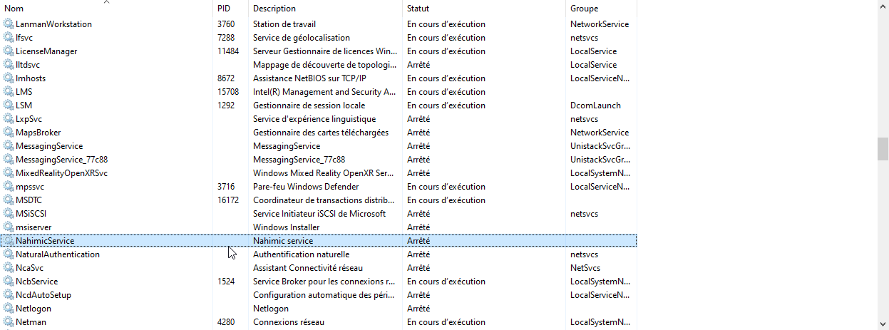

what programs do you have running in background like antivirus etc. what is the OS? is it up to date? have you tried starting your PC in safe mode and then run Houdini? if it is antivirus, then disable it and try starting Houdini. just some simple things to aid in troubleshooting. if H17.5 and 18 crash just after start then it sounds like it could be a video card driver.

absorbentghost
I found that turning of the NahimicServic fixed my crash issues .
Wow how did you found this?
Thanks a lot, I got a new pc yesterday and i got the same crashes as described here and was really worried. Finally i found ur solution here, thanks again
