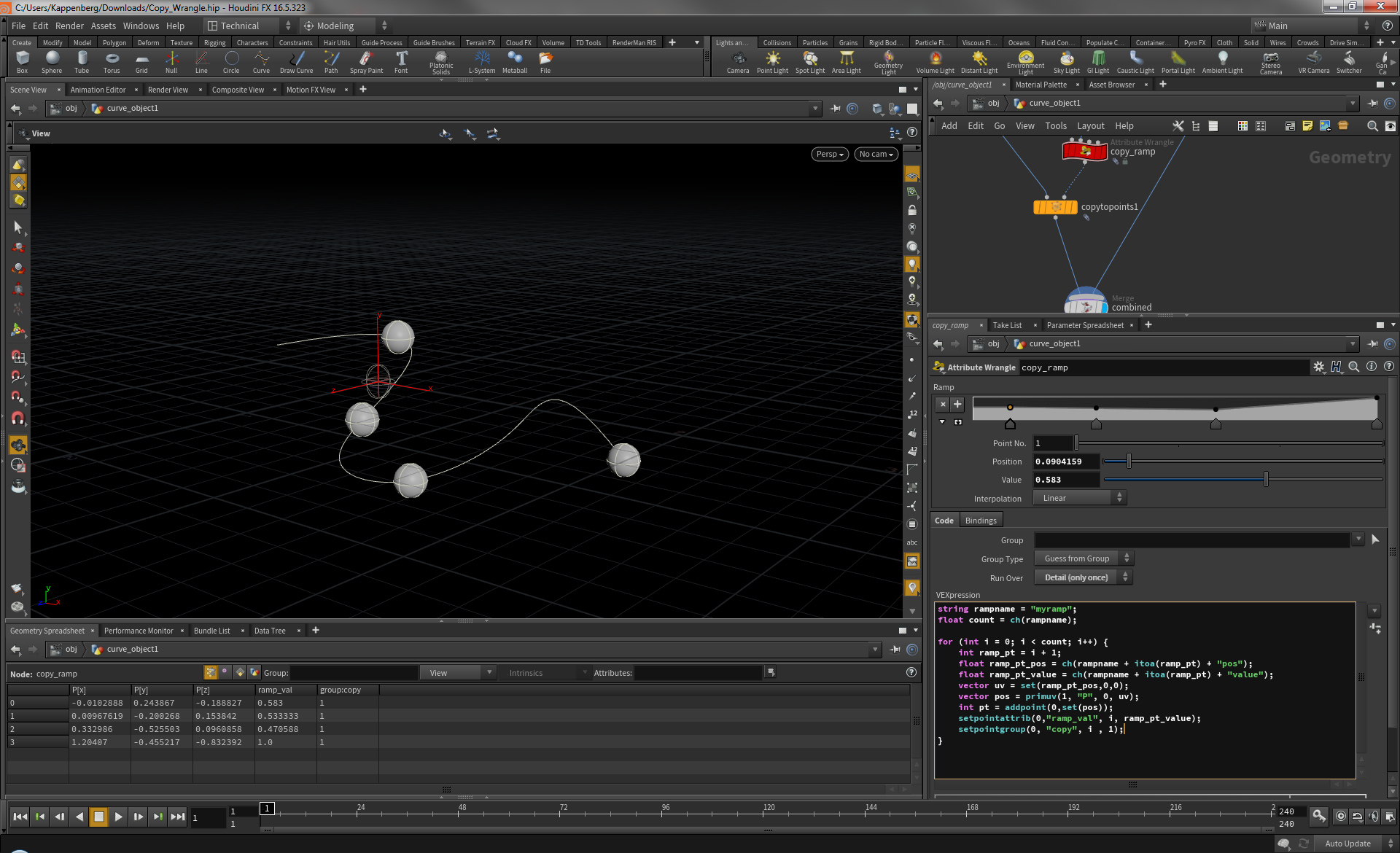

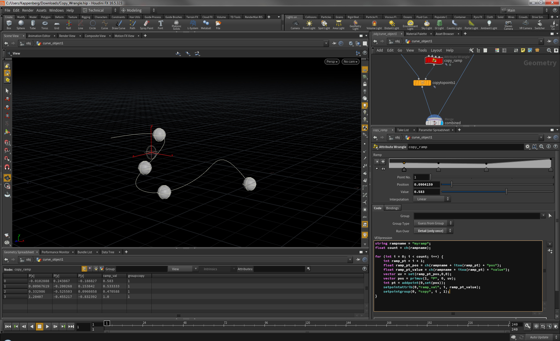

Same as lfranceschini's solution,
but as one wrangle.
Added “ramp_val” attribute… maybe you need it.
Eg.: Add a point wrangle after the “copy_ramp” with
@P.y = @P.y + @ramp_val;
Edited by matthias_k - Feb. 13, 2020 17:13:38
Copy_Wrangle.hip (82.7 KB)
483 posts
Joined: Dec. 2006
Maybe better code, with all ramp infos as attributes
string rampname = "myramp";
// use next line to create a ramp, you can not use variable as name here
// float ramp = chramp("myramp",0);
// see below, we add 1 because of the ramp marker numbers
// they start at 1 not at 0, i've added it here and for loop starts with  i = 1
float count = ch(rampname) + 1;
for (int i = 1; i < count; i++) {
    // create prefix, a markers name is rampname + markernumber
    // eg. myramp1, myramp2, ...
    string ramp_pt = rampname + itoa(i);
    // then add the value to grab, hover the Position label to see the name
    // eg. myramp1pos
    float ramp_pt_pos = ch(ramp_pt + "pos");
    float ramp_pt_value = ch(ramp_pt + "value");
    float ramp_pt_interp = ch(ramp_pt + "interp");
    // set the primuv vector to grab
    vector uv = set(ramp_pt_pos,0,0);
    vector pos = primuv(1, "P", 0, uv);
    // create a new point
    int pt = addpoint(0,set(pos));
    // and add desired attributes or groups
    setpointattrib(0,"ramp_pos", pt, ramp_pt_pos);
    setpointattrib(0,"ramp_val", pt, ramp_pt_value);
    setpointattrib(0,"ramp_interp", pt, ramp_pt_interp);
    setpointgroup(0, "copy", pt , 1);
Edited by matthias_k - Feb. 14, 2020 01:30:52

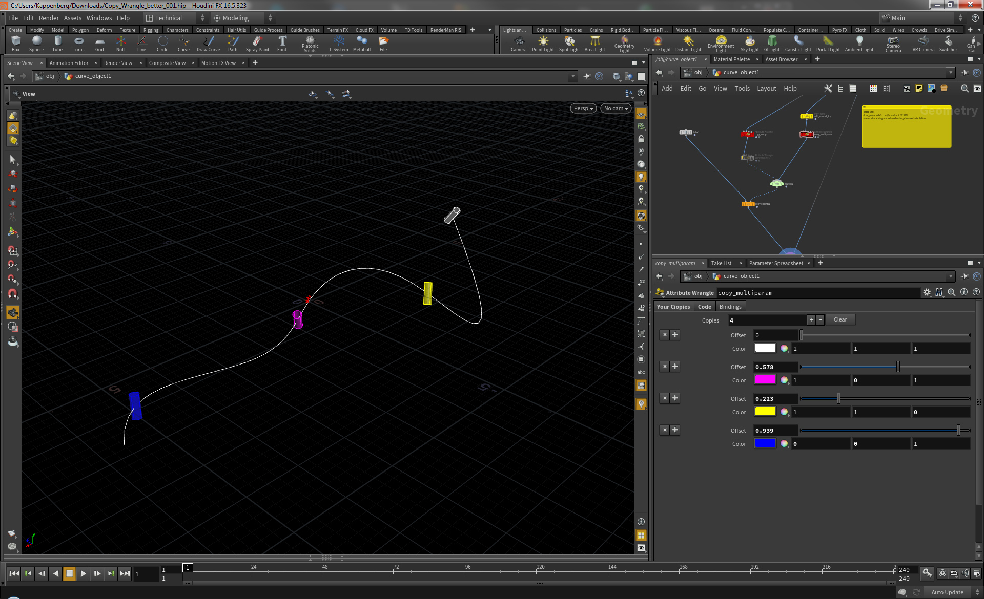

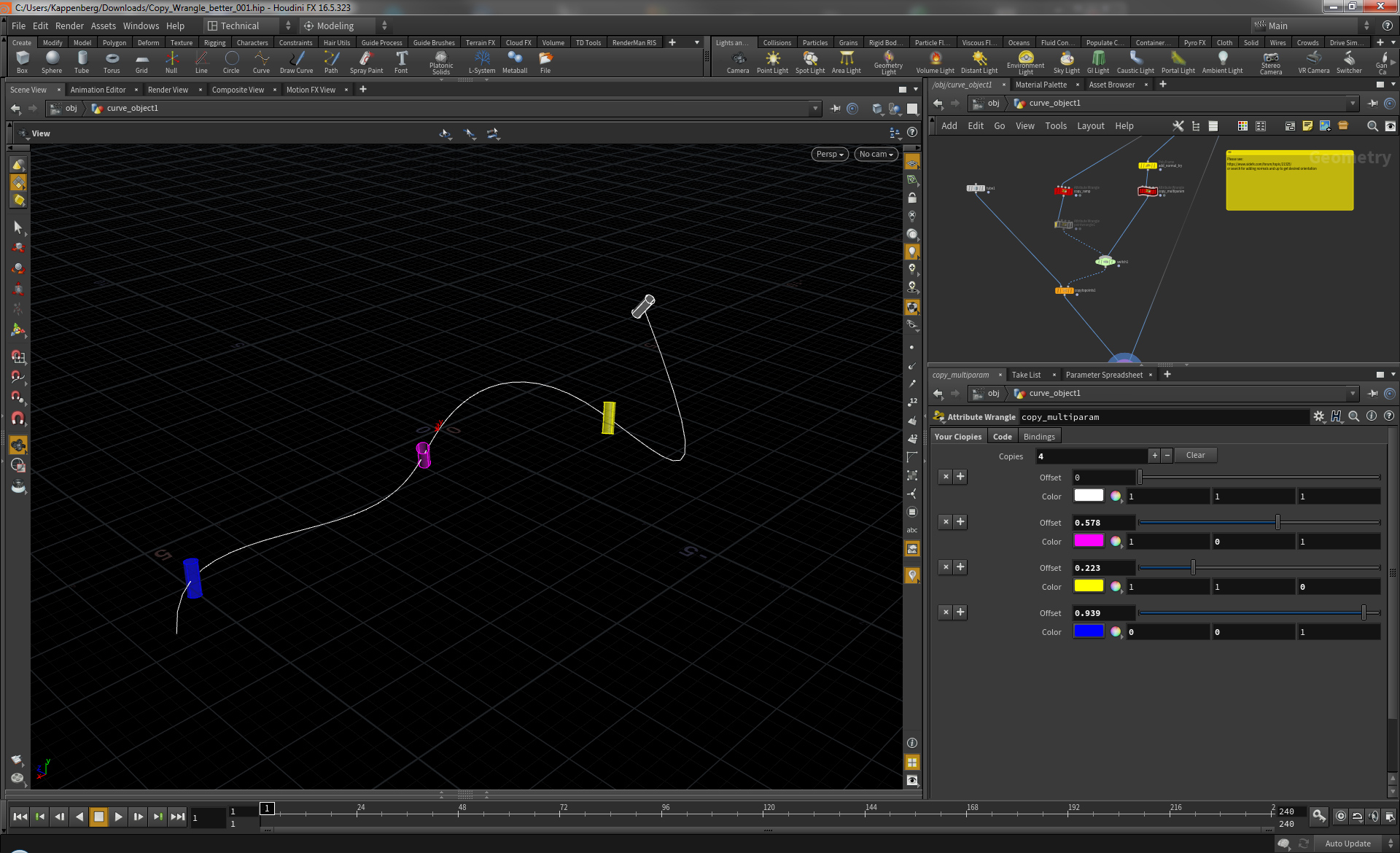

483 posts
Joined: Dec. 2006
As Enivob said, a slider makes more sense,
because you can then move “copy 3 before copy 2” on your path :-)
example how you can add arbitary attributes too via mutiparam add.
It's only a sketch :-)
Edited by matthias_k - Feb. 15, 2020 15:58:49
Copy_Wrangle_better_001.hip (98.9 KB)

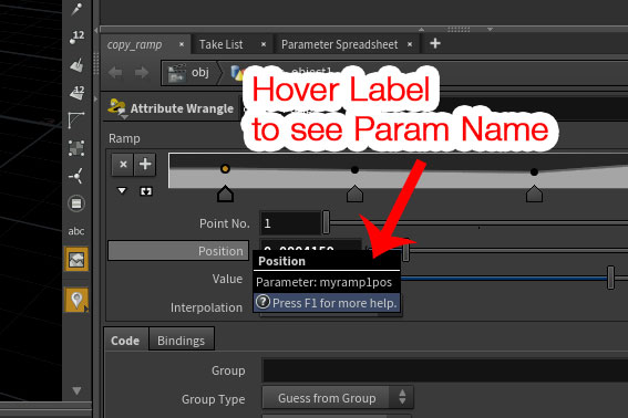

Do you happen to know where these “secret” ramp channel names (name+N+pos|value|interp) are documented? I can't find any references to them in the Houdini docs.
483 posts
Joined: Dec. 2006
I've simply hovered the “Param Label”
73 posts
Joined: March 2020
Thanks!! I submitted a documentation RFE for this to be added.
