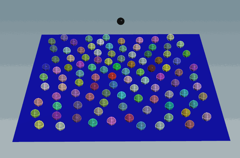

here's a basic one with RBDsolver SOP
The 1st object into merge is the AGITATOR, named piece0.

(it's ‘sleep’ property)ie. if nothing impacts you…you stay asleep forever.

so you'll see in configure, everyone is set to sleeping, except for the AGITATOR of course.
