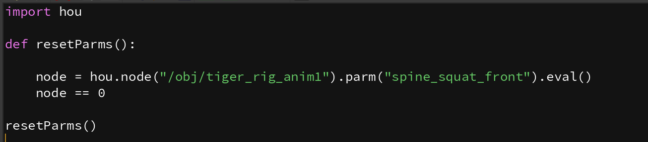

Hello,
I try to start writening a script to speed up work in Houdini and I struggle with it at the very begingn. As it is shown on my screenshot, for start I wanted to reset values ​​of my parameters to value of 0. But i get error shown on seceond screenshot.
My goal is to write few scripts that will help me to reset parameters of specific parts of the body.
I will be grateful for your help

I tried to modify it and now I get no error but nothing happens when I use the script. I attach screenshot below.

What are you trying to do?
The result of your comparison “node == 0” might be True or False, but you are not doing anything with that information - so what do you expect it to do?
What you ARE doing is: you are reading out a value from the node's parameter “spine_squat_front”. Then you are comparing that read out value to 0, done. There is no “functionality” in your function.

Thanks for Yur reply. I see my mistake with ( == ) changed it to ( = ) still doesn't work. What i want to do is to read out value of parameter in this case “spine_squat_front” and change it (reset) to value of 0. The goal is to write scripts that can reset many(specific) parameters at once.

My apologies - that's not how Python or Houdini work. If you assign a value to a variable from an external source, changing the value in that variable does not change the setting in the source …
What you want to do is change the value AT THE SOURCE (the node in this case), e.g. by
hou.node("/obj/tiger_rig_anim").setParms({"spine_squat_front":0})
… no need to read out the value before setting it.

or if it's just a single parameter you can use .set() directly
hou.node("/obj/tiger_rig_anim").parm("spine_squat_front").set(0)
or
hou.parm("/obj/tiger_rig_anim/spine_squat_front").set(0)

Okay I got it. So changed the code tried both solutions and I got errors shown below. I tried to google that error and it seems that i try to work with instance that has type None or doesn't exist ?

In your screenshot at the top of this thread, the node is called “tiger_rig_anim1”. Have you tried that?

My oversight. Thank You very much for Your help, now working just fine
