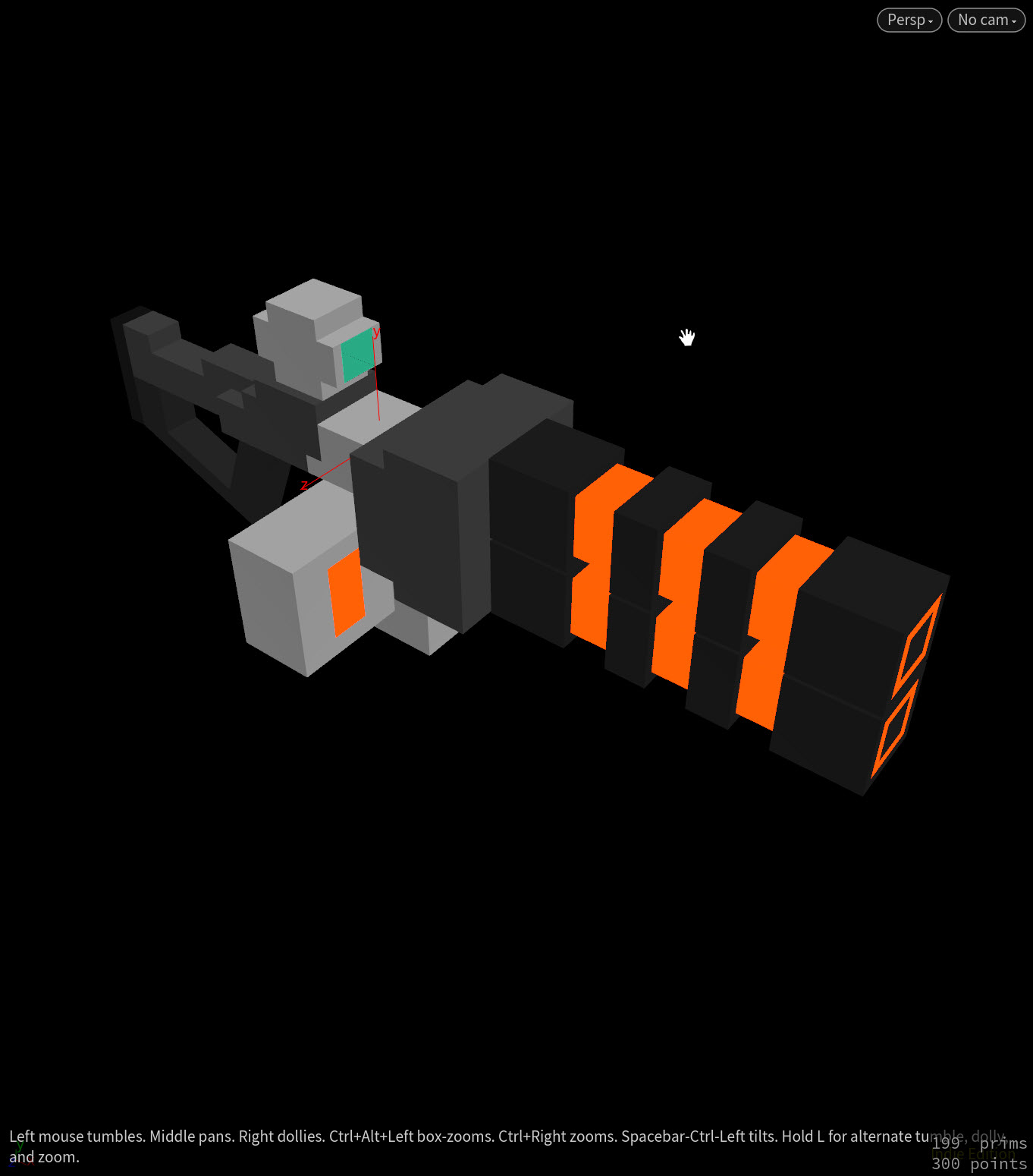

I prefer Houdini because I just used Blender for 2 months and I'm getting sick of multiple keybindings. To be honest, after playing around a bit yesterday it's pretty much ok. It all starts and ends with a good structure e.g. at a point I start to add the model as a background image in the node's background and then I place the nodes on the related areas … this helps to quickly find the related nodes.
I'm now blocking out everything with the curve node and adding my own digital asset with a combination of poly extrude and axis align… this helps speed up the modeling a lot. I was able to create 12 simple weapons yesterday … not so bad in general
Regarding the highlighting of the nodes .. sometimes it works and sometimes doesn't.
In general, it feels like minor fixes would make modeling in Houdini very good
