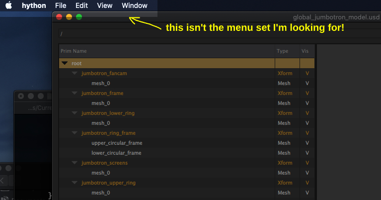

Just tried it though, its pretty broken unfortunately right now:
In fact I think even trying to run houdini terminal is broken under catalina because of new security changes with applescript. You need to add the houdini startup script to your .bashrc:
- USDView should use Storm, the fast openGL renderer as the default renderer, but that isn't supported on OSX (I hear a native metal port is being worked on)
- It's running within a hython wrapper, but hython is overriding the default usdview menus, so it's unusable
- Simple operations like hitting ‘f’ to frame geometry is pretty broken

Hm, I openened FullScene.usd from the SideFX LOPs tutorial, and the app quickly became non responsive/ and slow. I don't have the best specs as of now, but still.
Also didn't see an Windows-like, app embedded menu (I suspect you were looking for).
edit: I’m on macOS Mojave
