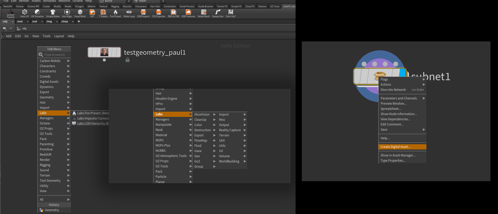

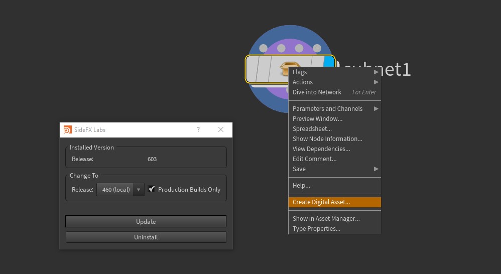

Thanks for this, but how to turn this on?
I've updated LABs to version 603 (latest this window shows me), but I still don't have this option for versioning with gui.

That version of Labs (603) should have VHDA support. Do you see any other Labs tools? Or none at all.

7 posts
Joined: Nov. 2019
Seems like everything working correctly, I'm using some of the tools, never experienced issues.
197 posts
Joined: July 2015
Do you have any other plugins / toolsets that might also modify the right-click OP menu installed?
I just tried 603 myself on a fresh install without anything else and it works for me.
Could you try renaming/deleting your preferences folder and try on a clean environment? (make a backup)
Paul Ambrosiussen
Technical Artist, Freelance
twitter.com/ambrosiussen_p
7 posts
Joined: Nov. 2019
Just checked on 18.5, it's working there, no longer issue for me, thank you, Paul.
