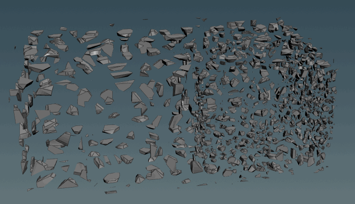

I want to delete all pieces of packed geometry with a volume smaller than x. I tried the measurement sop on packed geometry but it does not return any values.

Sorry forgot to include that was just a delete sop with a @volume<2 but it only deletes the primitives and not the whole piece so I am stuck with open pieces.

you already have @class attribute so before packing you could do Measure SOP and change Accumulate to Per Piece, then your Blast @volume<2 would delte whole pieces whose volume is < 2 instead of individual polys, then your pack node will just pack whole pieces that are left
however your pieces are not really connected (enclosed/watertight), so connectivity splits the geo into many open pieces, but once you fix that it should work
