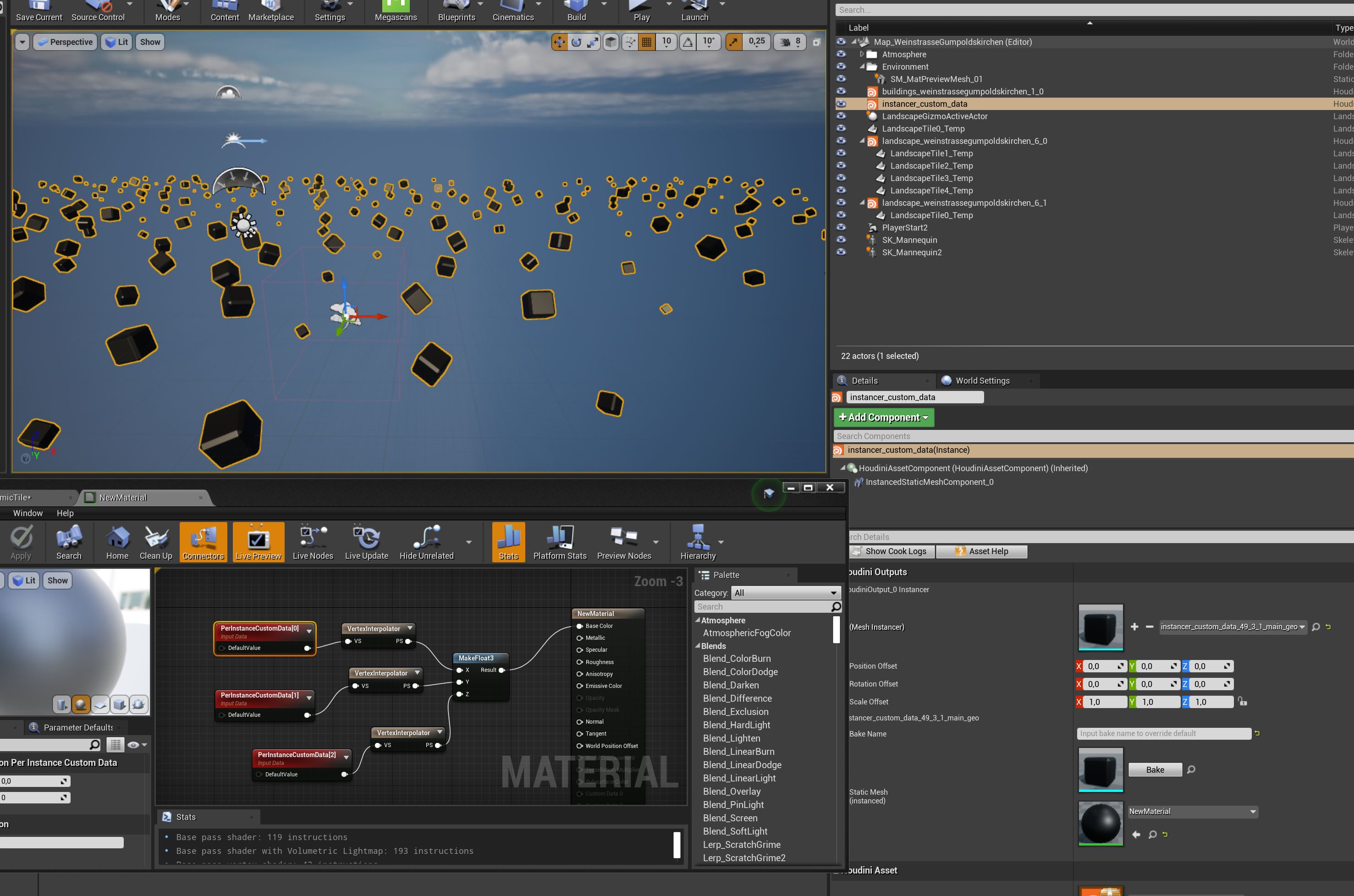

Can somebody help me with this setup? I can't get this to work. I want to assign a random color to my instances. I'm using the attribute instancer with the unreal_instance attr. set on my points. Then I add an unreal_num_custom_floats integer attribute set to 3 and then three float attributes unreal_per_instance_custom_data0,1,2 set to different values.
Inside Unreal I'm using PerInstanceCustomData in my material assigned to the object I'm instancing. But apparently it doesn't contain any values, it's always black. Any help would be greatly appreciated!

I have attached a little sample hda. It scatters some cubes onto points with the unreal_num_custom_floats and unreal_per_instance_custom_dataX attributes. In Unreal you apply a material to this asset that uses the PerInstanceCustomData nodes passed through a VertexInterpolator. This setup also works fine if you skip the Copy to Points bit in Houdini and use the unreal_instance attribute like you are doing.
Let me know if you have any questions.

Thanks again for the effort! I'm starting to feel stupid but I still can't get this to work. I apply my material to the "static mesh (instanced)" output of my instancer, correct? I had to rebuild your hda because engine won't allow me to import indie assets with a fx license. Can you try if the attached asset works for you?
