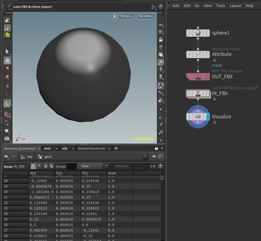

Point attributes are specific to Houdini and are not exported as part of the FBX file, so I think what you are suggesting is not possible. The only way to "export point attributes" is through use of an HDA, which as mentioned previously, is divided into its own parts and doesn't have easily accessible point per vertex attributes in Unity as you do in Houdini.

I looked into your files, and turns out that I was mistaken. Point attributes are exported as "LayerElementUserData". There's a Unity post with a sample project that reads UserData that might help: https://forum.unity.com/threads/how-to-import-user-defined-attributes-from-fbx-files.409877/ [forum.unity.com] . However, I tested this briefly, and it seems like Unity couldn't find the LayerElementUserData given the sample project. You might get better help posting your FBX in the official Unity forums.
