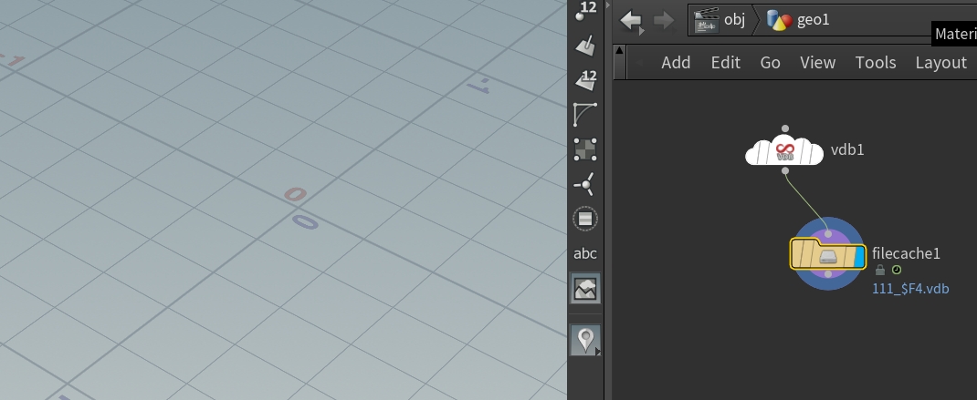

I have VDB-sequence, created in other soft. And can`t import it into houdini. Need example of node-system.

For importing into SOPs use a File sop.
For Solaris, use a volume LOP.
Joined: Nov. 2021
jsmack
OK. What i doing wrong? How i should reposition nodes?

Скриншот 08-11-2021 213701.jpg (34.9 KB)

delete the vdb sop

delete the vdb sop
ok. Delete, but nothing changes. Scene is empty/

Скриншот 09-11-2021 054705.jpg (164.9 KB)

I would try to plug your file node into a primitive node and modify the volume display mode

I resolve it. Was need on stage of create VDB to do export with many parameters. Temperature, density, fuel and other...
How about you learn a bit of Houdini first.
When you have a vdb sequence just a file sop should be enough, middle mouse click on the node shows you all volumes imported
