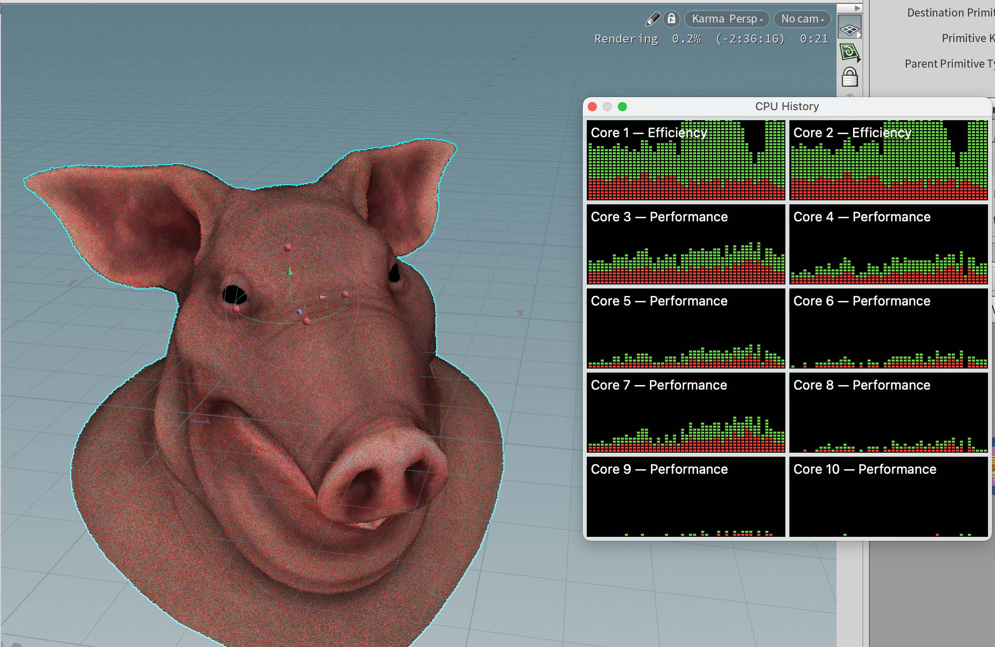

Never tried karma on the mac laptop before (mainly use mac for other things than rendering)
Just for fun opened up the stage, dropped a pighead and switched the viewport to karma… ops, does this thing work? Only the two efficiency cores work at all. Am i doing something wrong?
Edited by filipw - Feb. 3, 2022 14:35:55
187 posts
Joined: March 2008
Should work fine. Attached a screenshot of it rendering away at a pig head on my M1 MacBook Air (not sure why your render's going to take 2 hours though).
As you can see it's hitting the efficiency cores, and I'm not sure why. It does appear to hit them first and then ramp up the performance cores - if you render something a bit more complex than a pig head they will start to chip in. This doesn't seem particularly efficient. Karma's IPR thread reservation has always been a bit weird; it never seemed reserve cores as I'd expect.
139 posts
Joined: March 2018
To me this looks like it only uses the efficiency cores at all. In the case of your M1 it has 4 e-cores and those are used fully. On my M1 Max I have 2 e-cores and those are used fully. On my main TR Pro 3975wx workstation, all 64 threads are used.
187 posts
Joined: March 2008
It does predominantly use the efficiency cores. With a bit more geometry the other cores pick up some of the load, but it seems the efficiency cores are at 100% and the performance cores peak at 20%. Possibly that 20% is it picking up system tasks as the efficiency cores are saturated.
Seems like this is an Apple Silicon issue, rather than a Mac one; on my iMac, Karma happily renders away using all 10 core / 20 threads.

i reported this as a bug from M1Pro, but got a (reasonable) response that it is not officially supported, and on a non-M machine it works as intended, so i got my bug report dismissed
PS - render to MPlay will utilize all cores. viewport render is stuck with a couple of cores and that is pretty much it, no matter what you tweak in sliders

Yup. This issue is on our radar and we are looking into a fix to have all cores used on M1. No ETA at the moment though but sooner rather than later.

This has been fixed in 19.0.524.
