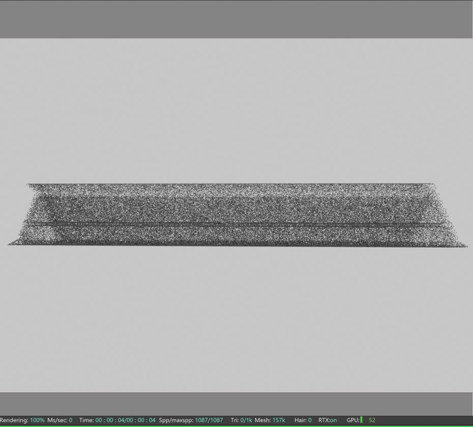

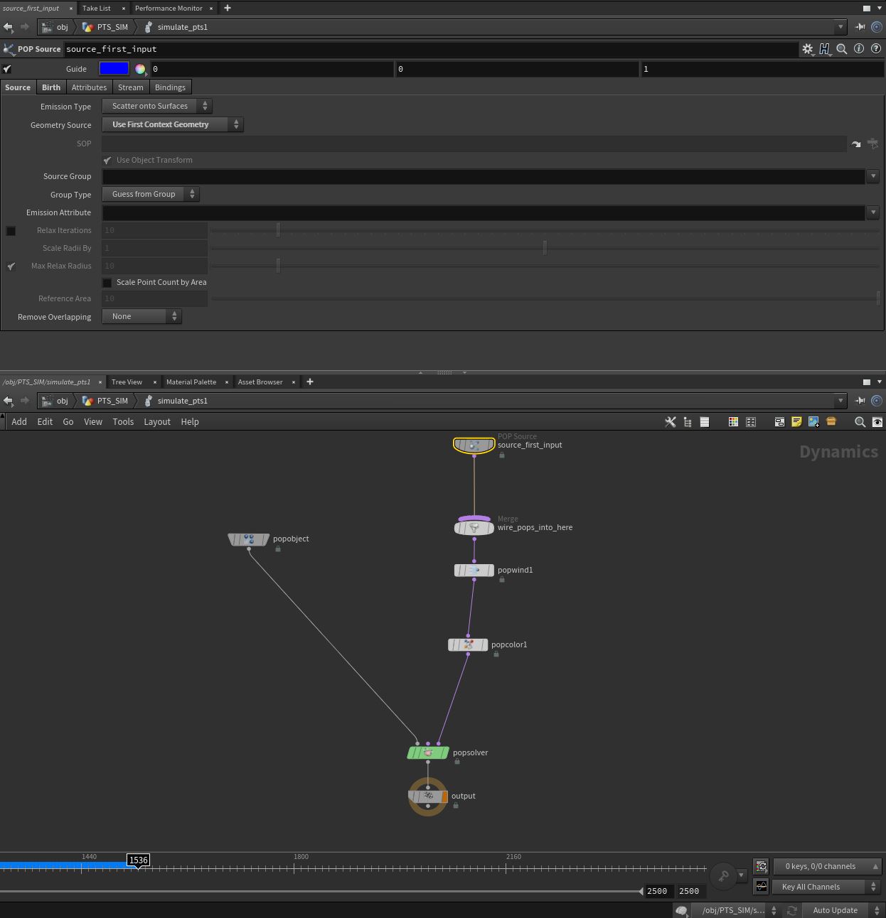

I followed everything from the tutorial above and added a popwind and a popcolor node. In the popcolor I used the alpha function for the fade out, it seems ok in Houdini, but when I export it as alembic and render it in c4d octane, there is no fade out. I don't know if the popwind and popcolor is the right approach. Also i need a smooth transition in particles from left (100%) to right (0%) in the outline text. I don't how i can set this up. Please, who can help me out?

I would never use popcolor node, everything you need to color the particles can and should be done outside
of the solver.
When you export data, the color attribute will be stored in the particles, but it is up to you to hook up
that Cd attribute in the other package/renderer. Just like Mantra will "use point color" you need to have Cd connected
up to your shader for it's diffuse color.

I don't fully understand how the animation is supposed to look like. But regarding the Alpha attribute, it's either an export problem or a shader problem. You need to make sure that the attribute actually arrives in C4D, and that the Octane shader reads it and uses it to control the particle opacity.
Regarding the color node, it's generally a good idea to do as little as possible within the sim. Your sim looks straightforward and probably doesn't take long to calculate, so it shouldn't matter much. In general, if you wanted to colorize from left to right, you could do so after the sim, by reading the particle's position and colorizing accordingly.
