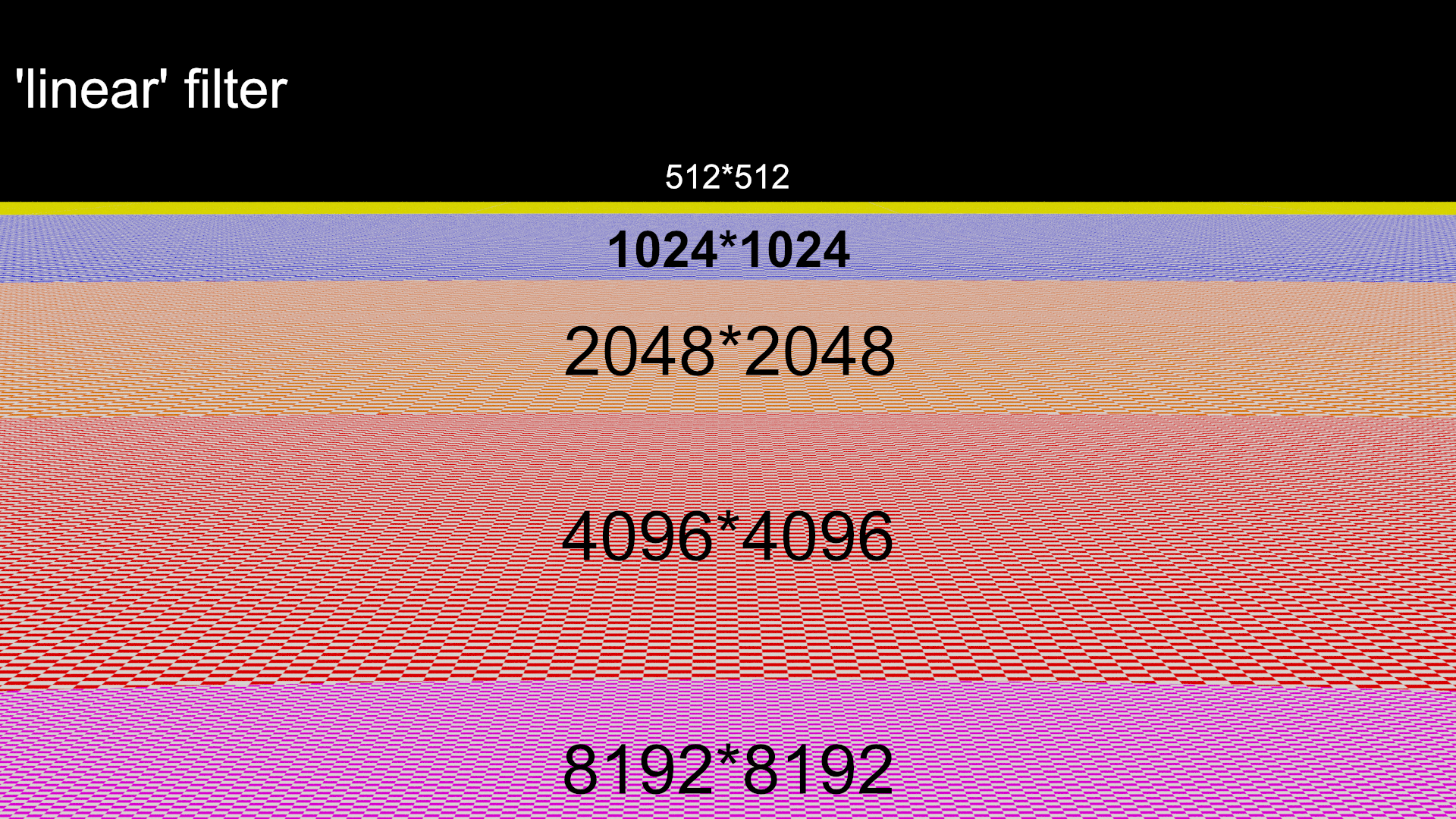

So, after some testing. Turns out switching the filtering type to 'closest' on the MtlxImage node just uses the highest mip level no matter what. So it was 'fixing' the blurry textures, but not really.
would be cool if we had GL style args like GL_LINEAR_MIPMAP_LINEAR, GL_CLOSEST_MIPMAP_LINEAR, etc
You probably don't want to closest as a workaround as it will alias on minification and look pixelated on magnification.
I think OIIO texture sampling just picks mipmaps wrong, rat sampling can be wrong too but it's usually erring on the side of too high of a mip level.
Anyone know if karma supports anisotropic filtering?

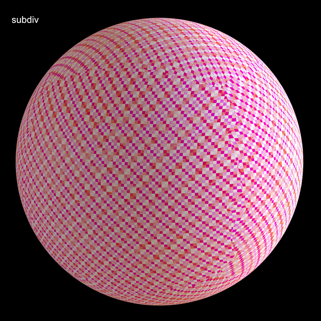

I could live with a small difference but the scene I am working on has a very noticable decrease in quality when using mipped exrs.
I think I found the cause. Here's a sphere rendered in Karma CPU with and without subdivision with a debug mipmap exr applied.
Without subdivision it's generally what I expect, you can see the separate mip levels.
With subdivision, it looks like several mip levels are blended on top of each other and as a result appears blurry.
I'm not smart enough to know if this is expected due to the difference between Houdini/OIIO filtering algorithms or if it's bug or what.
I don't know how to make the same debug texture in .rat format so I can't compare.
