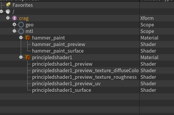

Looks like the Crag test geometry is using a principled shader
XPU only supports materialX and USD Preview Surface
Edited by johnp - Nov. 30, 2021 11:26:49
Crag's textures are also jpg's, XPU is probably erroneously gamma correcting the roughness map since the gamma correction parameter is not translated from the principled to usd preview surface.
