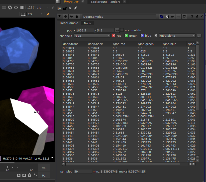

I am seeing very large numbers of deep samples generated, even with simple hard surface elements. In this example here are a couple of platonics rendered with Karma deep camera map.
When I sample the deep data in Nuke there are as 60+ samples per pixel. This is a lot of redundant deep data that makes the deep files slow to work with. Arnold for example has various alpha and depth tolerance controls to heterogeneously modulate the number of deep samples per pixel based on various depth and alpha heuristics.

dlee, here is another sample on a less lit area from the original image (DCM compression default of 5) still, quite a high number of samples at 22:

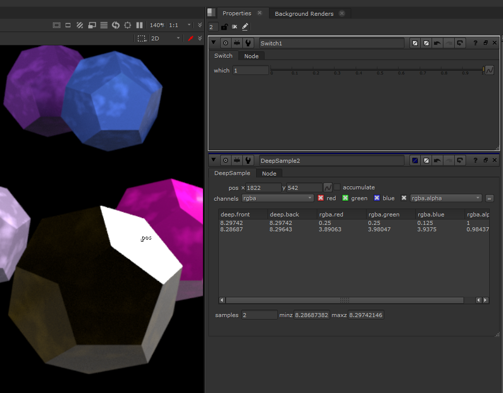

Inside the Karma ROP I was able to add an "edit render product LOP" to set the DCM compression to 10. (FYI the "DCM Render Product lop" inside the "karma render properties lop" appears to be using an old version of the render product lop and doesn't have any karma settings, i.e it's not possible to set DCM compression there, H19.0.622).
This resulted in a much reduced file size, and reduced deep samples:
