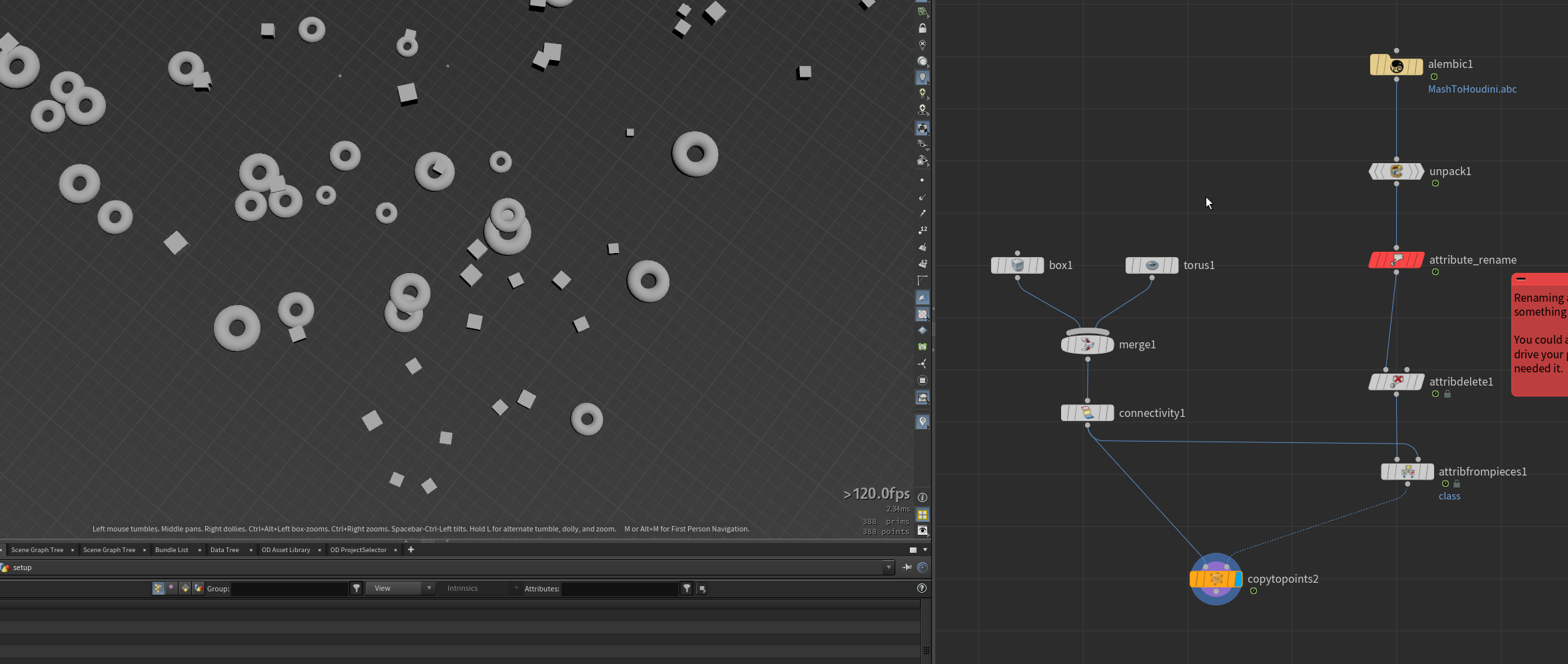

I had finally some time this weekend so here you go as you can see in these two screenshots the pts from Mash/BF are matching when you bring them into Houdini, with all attributes as well.
I wrote some explanations on sticky notes.
Make sure you are running the latest version of Bifrost 2.6 came out a few days ago.
Mash_BFToH.zip (104.0 KB)
