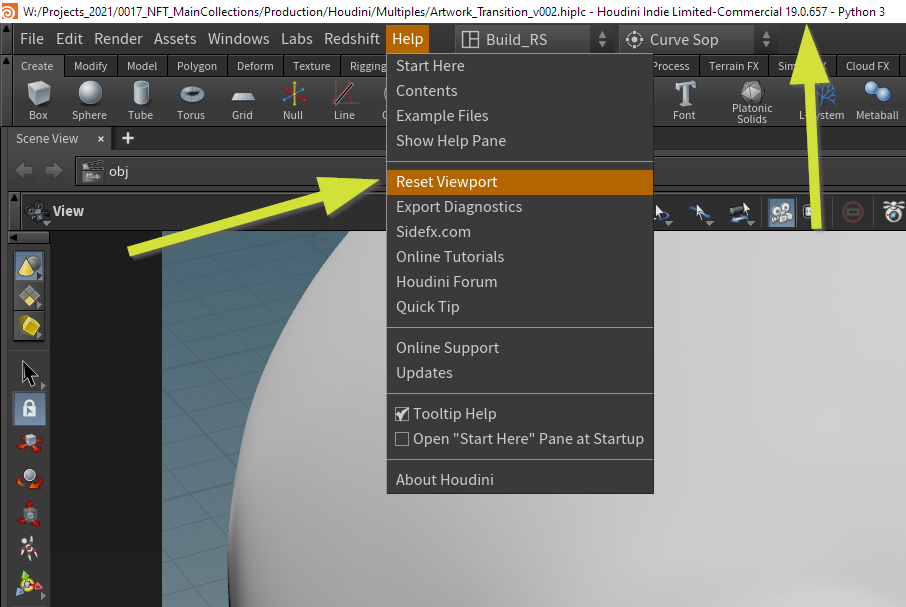

- jsmack
- 8380 posts
- Joined: Sept. 2011
N-G
Seems they have removed it from H 19.0.657!
It was never part of Houdini. They would never put a feature in mainline that capitulates to a bug like that. The menu is from the Labs plugin.
There's no need for the menu. A scene view can be made fresh by closing the viewer, and then undoing the closure from the pane's menu.

jsmackThank you @jsmack It is under the Labs menu I can see it now.N-G
- Robot_and_Robot
- 30 posts
- Joined: April 2015
N-GjsmackThank you @jsmack It is under the Labs menu I can see it now.N-G
Still there in mine
