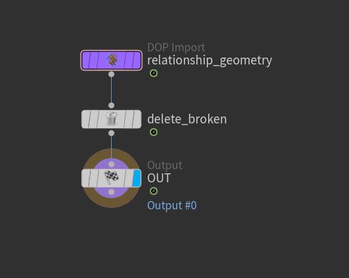

Sorry it's a month after the fact, but I stumbled over this bug today. There's a malformed network in the tool. Dive into the SOP Solver called "remove_broken" and rewire it so it looks like the attached image.
I've submitted a bug report,so this should hopefully be fixed soon. Fixed in 19.5.371.

BryanRay
I've submitted a bug report, <strike>so this should hopefully be fixed soon</strike>. Fixed in 19.5.371.
Thanks for posting this. It was the issue only showing in 19.5.303 and was driving me crazy.
It's working now.
