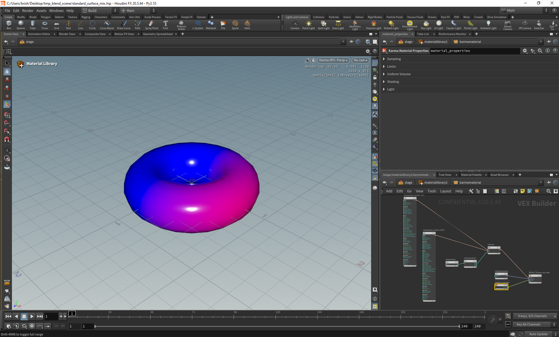

626 posts
Joined: May 2019
I'm not sure what issue you have.
But here is an example.
Does it work for you?
standard_surface_mix.hip (192.9 KB)
7 posts
Joined: July 2014
brians
Hey,
Yes that example file works on my side as well. I noticed however when I add another MtlxMix node after that one and add another surface mix it fails to render on XPU which is what I did in my project as well to layer different shaders, still works fine on CPU though (attached example). Is that a Karma XPU limitation at the moment then?
Thanks!
standard_surface_doubleMix.hiplc (200.4 KB)
626 posts
Joined: May 2019
eyellusion
Yes, it currently allows only the mixing of two MtlxStandardSurface nodes.
