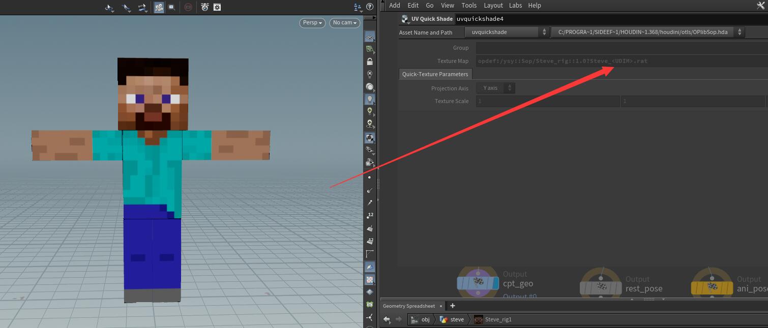

https://www.sidefx.com/docs/houdini/solaris/udim.html [www.sidefx.com]
I think the correct UDIM syntax is <UDIM> instead of writing out the quadrant number specifically.
But you said 'Other maps(color, roughness, transmission ecc..) work fine.' so I'm not sure what exactly happened.
