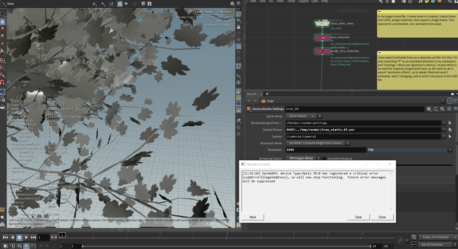

Hi;
I have a scene which I'd like to use XPU to render. Prior to today, I was working in this scene on a machine that contained one 1080 and one 1080ti graphics cards. The scene typically failed to render using these GPUs, I think because it was running out of VRAM. The indication I'm using for this is that when I shift over to Karma in the viewport, I see two OPTIX and one EMBREE process(es); after a few moments, the OPTIX ones say "fail", and the render soldiers on with the Embree process only (and, of course, this is punishingly slow).
So, I decided to roll the dice and invest in a shiny new 3090ti with 24GB VRAM, which showed up today. I installed it, ensured I had the latest drivers installed, loaded my scene and switched the viewport to Karma. The scene sat in an "initializing" state for nearly two minutes; I saw both OPTIX and EMBREE processes initializing. Then, crushingly, the OPTIX one said "fail". I tried resetting Karma and restarting the render, only now I see NO Optix process at all. Oddly, my Task Manager shows the GPU under some amount of load, though Karma seems to indicate it isn't seeing the card at all.
Other than trying to divine what's going on using just these viewport indicators, what other things can I do to debug this to better understand what might be going on?
Edited by dhemberg - Oct. 16, 2022 22:23:37
Screenshot 2022-10-16 211337.png (426.3 KB)

Firstly,
Intel HD Graphic 530 is selected inside Houdini maybe?
You can go Edit>Preference>Miscellaneous>OpenCL Device
to check which Graphic card is selected.
Secondary,
Im assuming that your RAM(Pysical one 29.5/31.9GB) is already run out to process OPTIX.
If you have a tons of polygons in your scene, and
if you import the scene via "Scene import" Node in Solaris, maybe you have to save Physical RAM.
So
1.Caching the scene into intermediate cache like .bgeo/.abc/.usd then
2.Importing the cache file using "file" node might save you to render your scene.
Fingers Crossed,

some thoughts:
1)
Can you get a basic scene going in XPU? (eg a single unshaded torus, with no lights)
If so, that is a start and we can work on from there
2)
if you open the viewport render stats, you'll see a more detailed reason as to why XPU failed
https://www.sidefx.com/docs/houdini/solaris/karma_xpu.html#howto [www.sidefx.com]
https://www.sidefx.com/docs/houdini/images/solaris/solaris_xpu_render_stats.png [www.sidefx.com]
Edited by brians - Oct. 18, 2022 22:58:52

Hi;
1) Yes, a basic scene renders fine; I can confirm the card itself is working.
2) this unfortunately doesn't seem to uncover any clues, and my experience so far is inconsistent; sometimes the card fails, other times it doesn't, and the stats and log don't seem to offer clues as to what's happening when. Either way, the render forges ahead; when it works, I get renders in minutes; when the card fails, I get renders in hours. Is there a way to say "Hey, if XPU is failing on a graphics card, bail on the render outright and tell me what went wrong"? Is there a verbosity level on the USD ROP LOP that might help? The logs right now (set to "render stats" don't offer any obvious clues.
Absent this, I'm doing some good ol' rolling-up-the-sleeves TD debugging. The failures seem to happen when I have motion blur enabled on a particular USD layer (in my case: tree animation generated by Labs Trees + Vellum). My spidey sense encourages me to wonder if I have a varying point count in my USD file that might be causing time samples (and, by extension, motion blur) to fail. The only way I can think to test this is by manually spelunking my USD to make sure point counts are not varying frame to frame.
I'm comfortable doing my own debugging; what I'm struggling with is the apparent lack of tools to pinpoint what might be going wrong. I've never dealt with a renderer that has this fallback behavior; I'm used to renders either failing or not, so this thing where the render continues with no messages about why the GPU side of it is failing is puzzling to me.

Are you able to reproduce the problem in the viewport? Or does it only happen offline (ie via husk)?
In Viewport:
Do you get a more detailed message in the viewport render stats?
Or... is it like... blank or something?
offline/husk:
There should be an error message printed out in the render log (ie to the terminal)
Something like this
"KarmaXPU: device Type:Optix ID:0 has registered a critical error cudaErrorlllegalAddress, so will now stop functioning. Future error messages will be suppressed "
Edited by brians - Oct. 23, 2022 22:34:57

brians
Hi; I get this. I *think* the relevant thing I should be noticing here is the PeakDeviceMemTotal (?). Is this suggesting my scene is trying to take up 400GB of memory?
brians
offline/husk:
Something like this
Yes, exactly, I see this exact message. I'm afraid it's not very helpful; I can easily understand when the GPU is failing (render times shoot through the roof), it's the "why" that I'm trying to pinpoint.
Edited by dhemberg - Oct. 24, 2022 11:09:21

I think I found a smoking gun.
Here is an archive of a very simple scene file setup:
https://www.dropbox.com/sh/xt6ozjuvpsi1tqa/AAA6n0SubrgdlgpYmiD5HJ_ba?dl=0 [www.dropbox.com]
The archive contains a hip file, and a folder containing USD files of a single static tree, and an animated tree. There's also a couple of textures in there, and this is where I think it gets interesting.
The scene file just reads the static tree, assigns a MaterialX Shader to the leaves that includes opacity and an albedo map driving subsurface:
When I disconnect either the subsurface or the opacity connection in the shader, the Optix crash disappears.
Am I doing something obviously illegal in this setup? I can't deduce from the Render Stats in the viewport what might be going awry.

Then, if I:
--disable the material assignment node
OR
--disconnect the Opacity Map from the Opacity input of the MaterialX nde (note again: no transmission is being involved here at all)
OR
--disable the animation sublayer
the Optix failure goes away (I have to restart Houdini to bring Optix back up after a failure, so the above actions are being done after freshly launching the scene).
I don't think this is a caustics/transmission issue. Or, if it is, it's not clear to me how to fix it from this thread so far.

dhemberg
Disabling caustics is all it took for it to work for me. I think there is bug there somewhere.

dhemberg
My (larger) renderable scene file is an archvis setup; these trees are outside windows, and I need light to come into my interior, but need to see reflections on the windows. Thin-walled refraction did not seem to be an obvious option in MaterialX, so I'm dealing with windows the hard, terrible way, which is to say I give them proper thickness and deal with awful render times, which is primarily why I'm interested in XPU to help things along. If I disable caustics, I simply get fully shadowed, black interiors.
You should not get black interiors, MaterialX in Karma enables fake caustics by default. You only need to enable caustics when you want cool patterns, not just to let light into an interior. Even with how fast XPU is, if you use true caustics you'll need 1000-1000000x as many rays to resolve it, as well as having to increase the color limit for indirect light to be as bright as your light sources.
