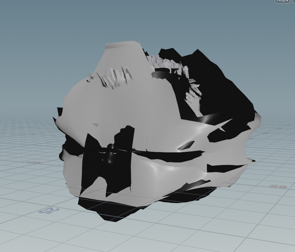

I'm trying to import a Character Creator model to houdini and convert it to a crowd agent.
I want to load motion clips later from different libraries (mixamo, other mocap sources)
I am able to remap skeleton with bone_deform, but I think I'm missing something with crowd agent.
If someone have any clue
Thanks !
Note : i'm using houdini 19.5.493
joining a zip file of my scene : https://drive.google.com/file/d/11PJELWF4Ci0nhGihcfkkzuWDNjNmpR5N/view?usp=sharing [drive.google.com]
Edited by c0y - April 17, 2023 12:56:54
52 posts
Joined: June 2016
Ok I think I've figured out my mistake :
I've connected the wrong motion clip from mixamo source, and not the retargeted animated rig.
Since I use the retargeted animation on the CC4 character, the agent layer works properly
