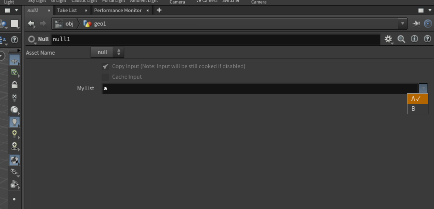

137 posts
Joined: Dec. 2019
Checkmarks seem to be available on menus built with HDK only (I only see them on compiled nodes), I couldn't find a way to do this when building an HDA, in many cases the trick is to promote a parameter that already has that menu with checkmark (group parameter in most cases).
As said by @jsmack, a checkmark string can help here, I tried this and it works fine :
a = ("a", "A")
b = ("b", "B")
pairs = [a, b]
menu = []
for p in pairs:
    menu.append(p[0])
    if p[0] in hou.evalParm("my_list").split(" "):
        menu.append(p[1] + " ✓")
    else:
        menu.append(p[1])
return menu
