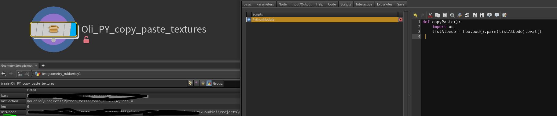

- SWest
- 313 posts
- Joined: Oct. 2016
Hi!
Python is good for learning because it usually provide great error reports.
"local variable 'listAlbedo' referenced before assignment.
Your code is not using a defined variable. The method you are calling expect a string as an input.
To get rid of that error message you either define listAlbedo e.g. on a line above listAlbedo = 'listAlbedo' or you simply add quotes around your call. Like this: listAlbedo = hou.pwd().parm('listAlbedo').eval().
Cheers!
