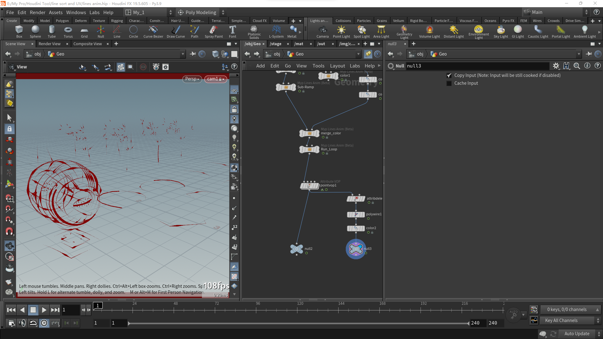

Here is an introduction to the tools:
I made a scene and processed the model of rules into a very scary model. Their point sequence is messy and the trees intersect severely. I will use this for testing.
With my HDA tool, you can create and use the four major functions multiple times, including detecting models (Check), preprocessing models (Pre-Do), coloring and compositing (Color), and moving along lines (Run Loop).
1. Check model (Check):
Can detect poor models for color differentiation, such as useless points, closed loops, intersections, and trees
2 Preprocessing model (Pre-Do):
Prepare the model for future use.
To create an animation, one must consider the orientation of the animation. Of course, if you don't choose anything within the group, it can still look great, but the tree doesn't think so.You can choose a group, specify the starting point of the line, or choose a second group, which can specify the zero direction of the closed circular line.
Randomness allows lines outside the previous group to be randomly oriented, and groups with random directions can precisely randomly select the desired lines. So both specified and random directions can be easily mixed and controlled.
It can also subdivide curves, needless to say, it's very simple
3. Color and Composition (Color):
Color (Make). Contains general attack gradients, sine waves, noise, and randomness.
Sub Ramp (Sub-Ramp). Able to separate areas of messy color blocks, and re gradient each color block according to the direction of the curve.
Merge (Merge). Can control the mixed mode, forward and backward, and weight when merging two nodes like Nuke software
4 Run Loop Color (Run Loop):
Normal offset Color (Offset), which offsets colors in the direction of the line and can exceed the line head and tail
LoopOffset Color (Loop_Offset), different from the above, can be looped, whether the line is sealed or not, and can move in a loop with the head and tail connected
