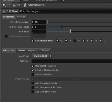

Scene is a bottle with a sphere emitting flip fluid (narrow band).
Bottle is around 60cm radius, 1.2meter high. The target is simple: fill up the bottle and make the liquid set still.
I watched tutorials and tried many setting mixture.
Fill new volume on/off
APIC / Flip
Substep 0.2 to 1
Min Substeps / Max Substeps
Ressed Particles on/off
Suface oversampling 1.5--3.0
Oversampling Bandwidth 1--3.0
Death Threshold 1.5--3.0
Random Seed set $T
Apply Particle Separation on/off
Separation Rate 1--2.0
Particle Separation 0.03--0.003
Gird Scale 1.2--2
Initial Data / Input Type : Particle Fied / Narrow band
Add Divergence Field
Volume Collisions / Division Size 0.01--0.1
Attach pre cache *.sim file in "DOP Network / Initial State"
PC: AMD 3950x , RTX 3090, RAM 128G, Cach disk space 1.5TB available, Project disk space 4TB available.
Houdini 20.0.590 non-commercial.
The scene always always stop fill the object at some point.
Soooooooooo frustrating.
Many thanks for any solutions~~!

After reading some videos and documents. I found that the Particle Separation, Particle radius scale, Grid scale are the most crucial parameters.
And I found that once they were set. While in running the FLIP dynamics, their parameters can’t be animated to prevent “dissolve volume” due to the particle are too “crowded”.
I'd say just Particle Separation
I have never touched Particle radius scale and keep Grid scale mostly between 2 and 1.5 since they are both relative to Particle Separation
you may not want to just randomly tweak them especially without understanding how exactly it affects your sim
what's more important is to look at the Collision guide on the FLIP Object (not on the static object) and see whether you have enough resolution to define the collision shape
