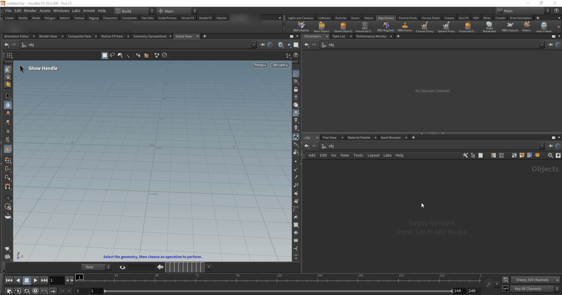

I was about to report that as a bug. The issue isn't actually with the vellum solver. In houdini 20, if you create a subnet in a dopnet, the viewport won't update when inside the subnet. When you double click the vellum solver sop to go inside, it actually takes you inside a subnet in the dopnet, hence why it doesn't work. You can re-create the issue like this:
1. Create a sphere and select it
2. In the rigid body shelf on the right click RBD objects
3. Go inside the autodopnet
4. create a subnetwork
5. attach the subnetwork to the post solve of the rigidbodysolver node
6. go inside the subnet
you will notice the viewport will not update.
going to report this issue now.

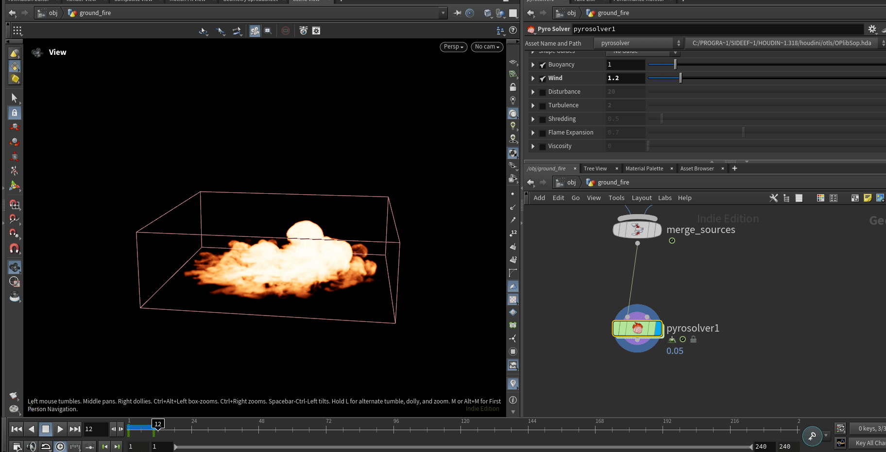

please can anyone help? its still broken in version 20.5.318 for the pyro solver.
edit: I finally got it working after re-opening the project/resetting the viewport multiple times.
edit 2: It's still glitchy compared to 19.5 but at this point I give up as I have found workarounds.
Edited by evanrudefx - Aug. 7, 2024 18:25:40

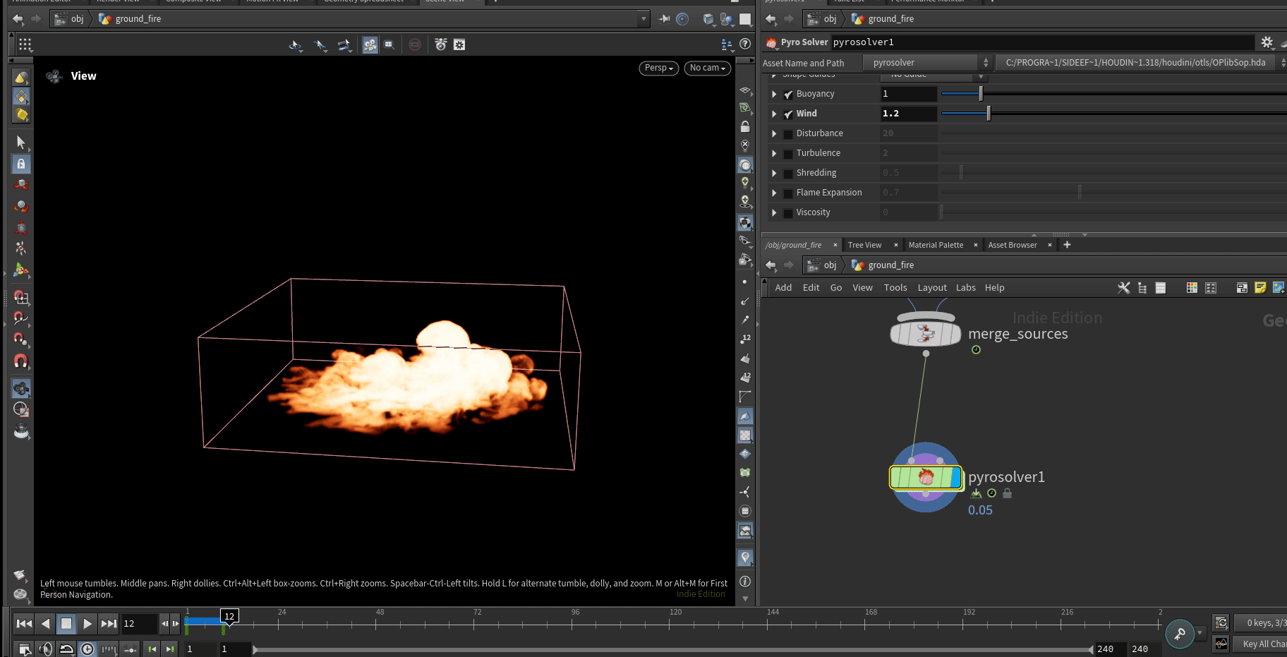

viewport glitch.gif (1.3 MB)
Thanks,
Evan
224 posts
It's still broken in 20.5.315...
295 posts
Joined: Feb. 2016
wanglifu
Yea, its actually worse than before. Everytime I switch back to a dopnet I have to reset the viewport and disable/re-enable a node. Its so bad.
