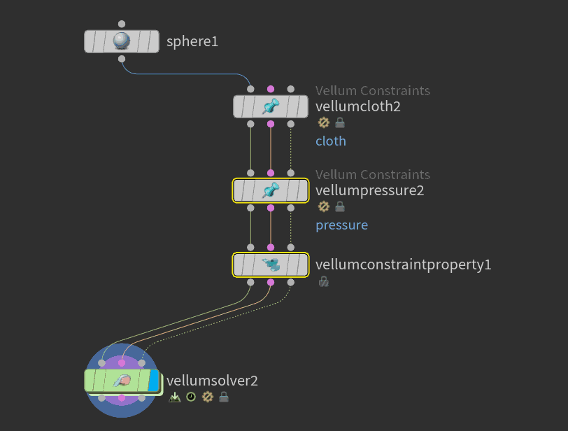

Guys, you will be surprised, but disconnecting a node is in the menu and you can simply assign a key to this action. I assigned X to myself and my node is disconnected, leaving the nodes above and below connected.

Just click this:
Screenshot 2024-07-19 190812.jpg (52.4 KB)

There is a config for this
But I'd suggest to not use shaking motion with mouse.
Screenshot 2024-07-19 191239.jpg (24.6 KB)

OMG...that`s it...
Oh wow! How have I missed that setting all these years? Thanks for pointing that out
Edit: set it to 0.2 and it's much much better for me now
