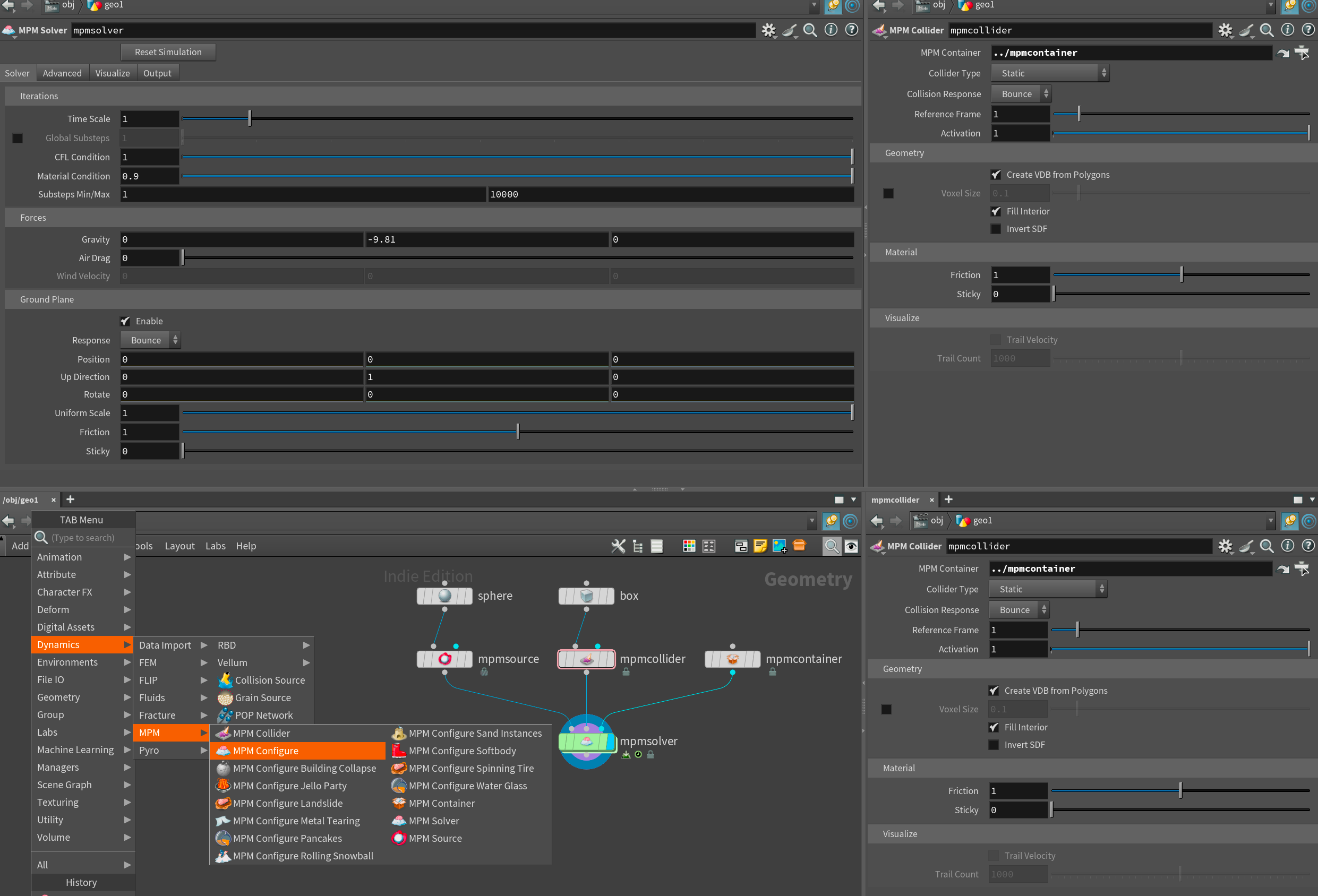

Hi Everyone!
I'm new to Houdini but have about 4 years experience with Cinema 4D/Redshift. In a new scene I created an MPM Configure node and started the sim. Before caching the sim runs at about 20 frames-per-MINUTE! And, I see very little activity on the GPU. Is there something I need to configure or would that frame-rate be considered normal?
I'm on MacOS, Intel Xeon 16-core, and AMD Radeon W6800X. This GPU does support OpenCL 1.2, which ,I believe, is correct for MPM. GPU has 32 GB of VRAM. And the system has 224 GB or RAM.
Any ideas or suggestions would be greatly appreciated!

Simple MPM Configure at 20 Frames-per-MINUTE
