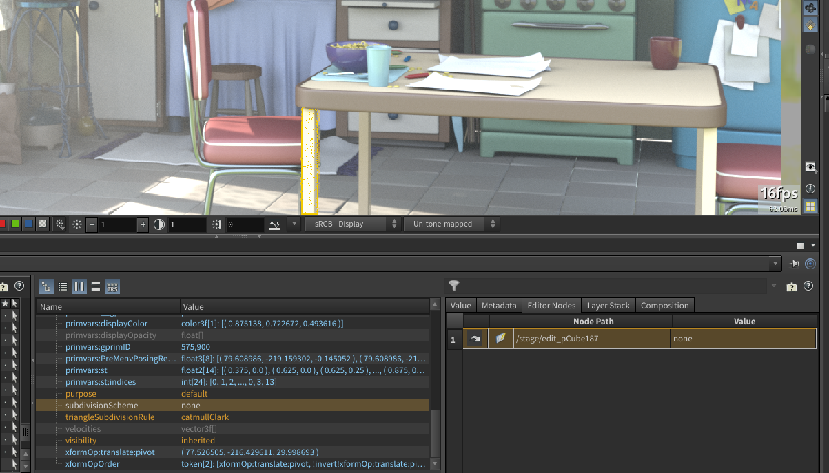

i really miss feature to find, where given override to parameter happens
We do have something for this - "Editor Nodes". For example, here I'm trying to track down where the subdivision scheme got set to "none" and can see it was in "edit_pCube187".
Edited by robp_sidefx - Jan. 30, 2025 04:12:50

robp_sidefxmartinkindl83
That's awesome. Had no idea.
Learning every day.
Thank you for sharing.
