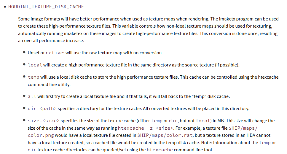

I use the variable {"HOUDINI_TEXTURE_DISK_CACHE" : "temp"} that's normaly :
will use a local disk cache to store the high performance texture files. This cache can be controlled using the htexcache command line utility.
But that seems bugged apparently..

Would be great to be able to set that option in env json as well so there is no need to write it in cmd every time.
291 posts
Joined: Feb. 2016
That seems to already be possible with `HOUDINI_TEXTURE_DISK_CACHE`
https://www.sidefx.com/docs/houdini/ref/env.html [www.sidefx.com]
