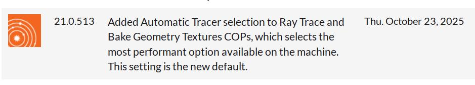

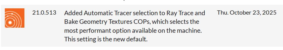

Are you running 21.0.513+?
This was added in 513:
Might fix this
I also think @tamte is correct that you should be able to fix this by modifying the parameter
