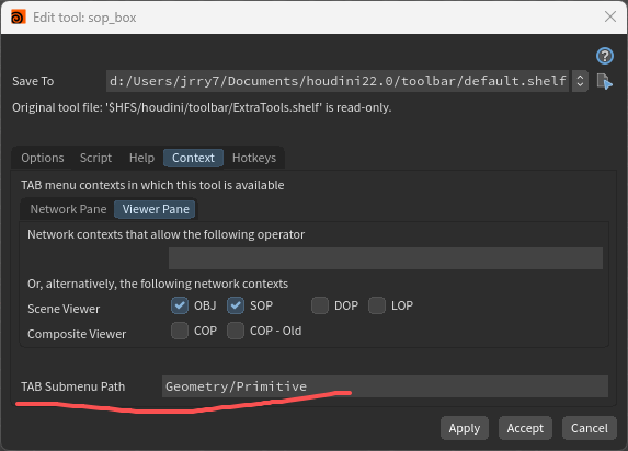

689 posts
Joined: 11月 2013
They come from shelf tool or hda(include factory inner) and can be edited in type property or shelf 'edit tool' window.

620 posts
Joined: 3月 2014
jerry7
Thanks , that set me on the right track.
